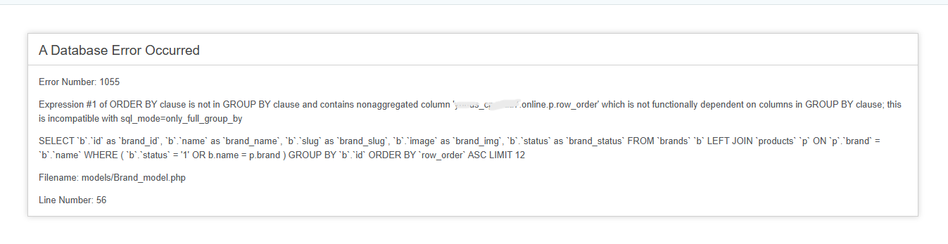

How can I disable this online_Full_group_by
Hello my good friends. Please, I want help in disrupting only_full_group_by.
I contacted the script developer told me to disable this, how I can disable.
Next time, please, copy and paste the error, it’s ok to provide the screenshot but provide also the plain text.

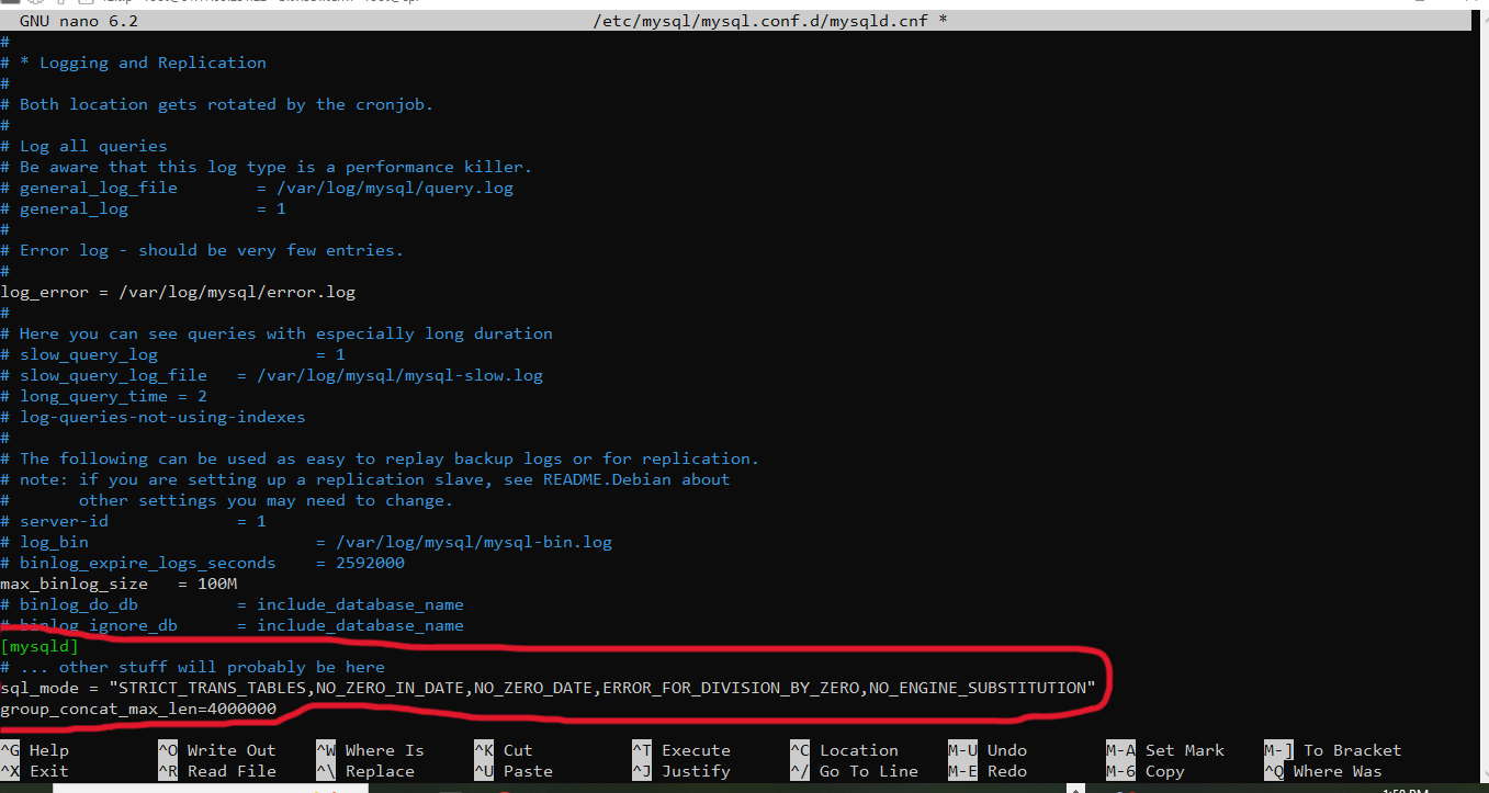

In fact, I did this in this place before the problem occurred. When I followed the instructions from one of the sites, the problem I’m experiencing occurred.
Now I have a big problem because of this explanation that I am suffering from and I cannot solve this problem.
This is the message I received via my email.
Can’t connect to MySQL localhost:3306
ERROR 2002 (HY000): Can’t connect to local MySQL server through socket ‘/var/run/mysqld/mysqld.sock’ (2)
I can’t even make any backup via Download Database.
I made a mistake because of my recklessness without thinking and what happened to me happened. I do not know how I can solve this problem.

And what did you change, only sql_mode? Did you start getting the errors after that change, or how/when did it happen?
Check the error log: /var/log/mysql/error.log
Yes I changed sql_mode just 2 days ago at the same time when I changed it.
This is what it looks like to me.
root@cp:~# /var/log/mysql/error.log
-bash: /var/log/mysql/error.log: Permission denied
root@cp:~#
It’s a log, you can’t execute it, you must check the content.
For example:
tail -n20 /var/log/mysql/error.log

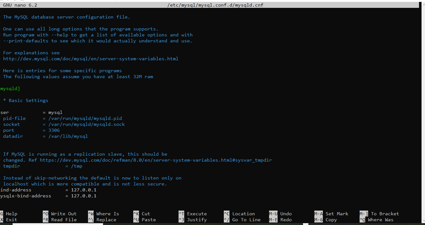

root@cp:~# tail -n20 /var/log/mysql/error.log
2025-09-02T14:41:59.612641Z 0 [System] [MY-010116] [Server] /usr/sbin/mysqld (mysqld 8.0.39-0ubuntu0.22.04.1) starting as process 1754124
2025-09-02T14:41:59.667325Z 1 [System] [MY-013576] [InnoDB] InnoDB initialization has started.
2025-09-02T14:42:01.784833Z 1 [System] [MY-013577] [InnoDB] InnoDB initialization has ended.
2025-09-02T14:42:02.804215Z 0 [Warning] [MY-010068] [Server] CA certificate ca.pem is self signed.
2025-09-02T14:42:02.804327Z 0 [System] [MY-013602] [Server] Channel mysql_main configured to support TLS. Encrypted connections are now supported for this channel.
2025-09-02T14:42:02.817038Z 0 [ERROR] [MY-000068] [Server] unknown option ‘–GNU nano 6.2 /etc/mysql/mysql.conf.d/mysqld.cnf’.
2025-09-02T14:42:02.817220Z 0 [ERROR] [MY-010119] [Server] Aborting
2025-09-02T14:42:04.267653Z 0 [System] [MY-010910] [Server] /usr/sbin/mysqld: Shutdown complete (mysqld 8.0.39-0ubuntu0.22.04.1) (Ubuntu).
2025-09-02T14:42:05.111499Z 0 [Warning] [MY-011070] [Server] ‘Disabling symbolic links using --skip-symbolic-links (or equivalent) is the default. Consider not using this option as it’ is deprecated and will be removed in a future release.
2025-09-02T14:42:05.114679Z 0 [System] [MY-010116] [Server] /usr/sbin/mysqld (mysqld 8.0.39-0ubuntu0.22.04.1) starting as process 1754198
2025-09-02T14:42:05.162986Z 1 [System] [MY-013576] [InnoDB] InnoDB initialization has started.
2025-09-02T14:42:06.722570Z 1 [System] [MY-013577] [InnoDB] InnoDB initialization has ended.
2025-09-02T14:42:07.500542Z 0 [Warning] [MY-010068] [Server] CA certificate ca.pem is self signed.
2025-09-02T14:42:07.500630Z 0 [System] [MY-013602] [Server] Channel mysql_main configured to support TLS. Encrypted connections are now supported for this channel.
2025-09-02T14:42:07.513581Z 0 [ERROR] [MY-000068] [Server] unknown option ‘–GNU nano 6.2 /etc/mysql/mysql.conf.d/mysqld.cnf’.
2025-09-02T14:42:07.513774Z 0 [ERROR] [MY-010119] [Server] Aborting
2025-09-02T14:42:09.053790Z 0 [System] [MY-010910] [Server] /usr/sbin/mysqld: Shutdown complete (mysqld 8.0.39-0ubuntu0.22.04.1) (Ubuntu).
2025-09-02T14:42:09.819843Z 0 [Warning] [MY-011070] [Server] ‘Disabling symbolic links using --skip-symbolic-links (or equivalent) is the default. Consider not using this option as it’ is deprecated and will be removed in a future release.
2025-09-02T14:42:09.823440Z 0 [System] [MY-010116] [Server] /usr/sbin/mysqld (mysqld 8.0.39-0ubuntu0.22.04.1) starting as process 1754248
2025-09-02T14:42:09.874496Z 1 [System] [MY-013576] [InnoDB] InnoDB initialization has started.
root@cp:~#
In this file /etc/mysql/mysql.conf.d/mysqld.cnf you have incorrectly added this line –GNU nano 6.2 /etc/mysql/mysql.conf.d/mysqld.cnf. Edit the file again, delete the line and restart the database.
Do I add this using the command prompt or is it in the admin panel hestiacp?
From the command line, but you must delete that line, not add it.
Yes it works fine finally this problem is solved.Thank you so much from the bottom of my heart. You are a helpful person.
