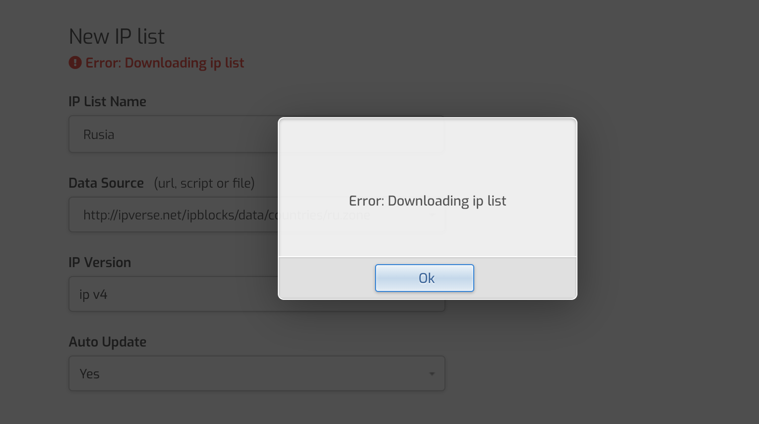

my hestia was updates, i am try to add Rusia ip list on my hestia and got this
that is very strange after Run dig ipverse.net
it start to downloading the list
probably related to the same dns problem? if your VM can’t resolve the IP (like ipverse.net) from the url you give there, a download obviously will fail.
maybe you already have some blocking-lists installed and these prevent from either proper ns-resolution or accessing these sites.
I recommend checking your settings in that regard and especially trying to simply curl/wget the URLs you want to use - something seems off with your general settings, not hestia related though.
are you eventually using some additional dns-related services like powerdns or other stuff that might cache dns-request or handle them locally instead of properly forwarding them?
no i dont use any other dns service.
then try changing the default dns-servers your VM uses, maybe that’s some old entries from contabo and not reliable enough… no idea, your system, your reponsibility :wink: :wink:
I am not expert on linux, can you tell me how to change the dns server?
I’m sorry, but as already written, this not related to hestia.
