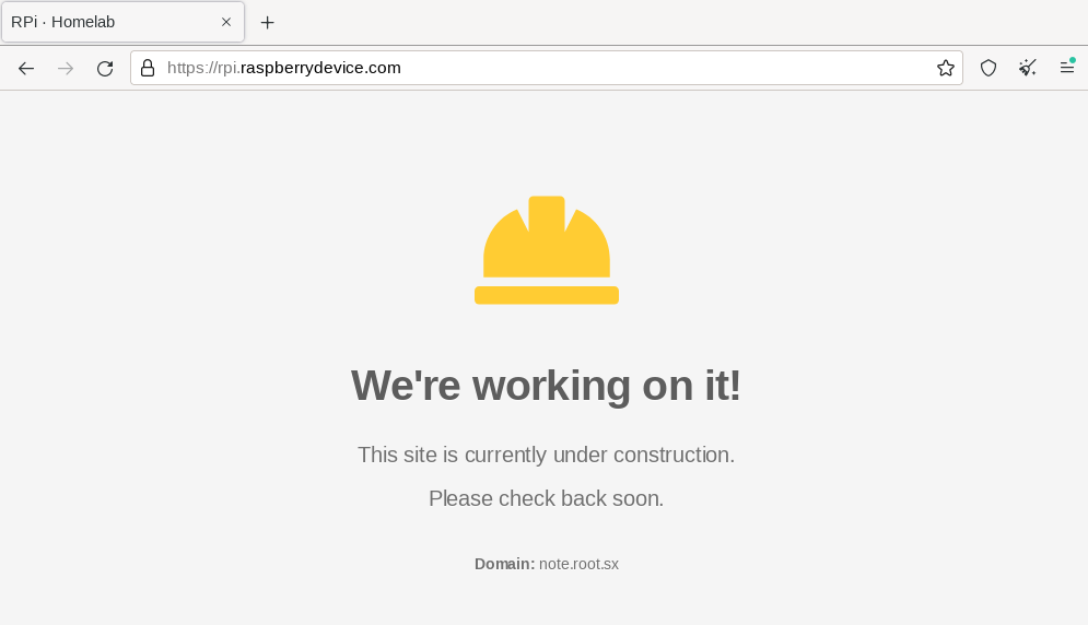

So, currently HestiaCP is not supporting IPv6 yet, ok noted. Just wondering, any of you can access rpi.raspberrydevice.com webpage? - hosted by my homelab HCP.
As my ISP doesn’t support IPv6, I used TOR browser and this is what I see:

Which means my webpage is accessible from outside. Now the problem is just the Hestia Control Panel port can’t be access from outside network. Thank you for helping me testing, appreciate it.
