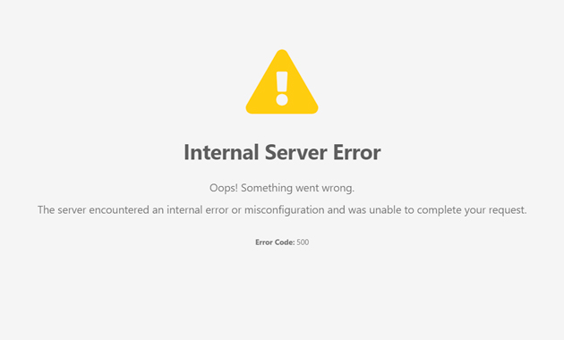

Until to dot 6 the panel hestiacp worked. after the proceed the last dot, hestiaco stopped to work with error 500 (before to edit the panel.html file) (nothing log errors)
now I cannot check it…I stopped the CSF installation and I installed iptables -fail2ban script.

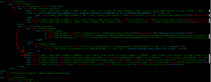

My /usr/local/hestia/web/templates/admin/panel.html looks like below. Not quite exactly as the instructions in this post that says that I should add the l-menu__item tag directly below <div class="l-menu clearfix noselect">
=> <div class="l-menu__item <?php if($TAB == 'SERVER' ). Because my row <div class=“l-menu__item <?php if($TAB == ‘SERVER’ ) is inside the l-profile noselect” element.
The CSF link only works when I put in the l-profile noselected element. And put in the element there, and replace the existing old CSF element.

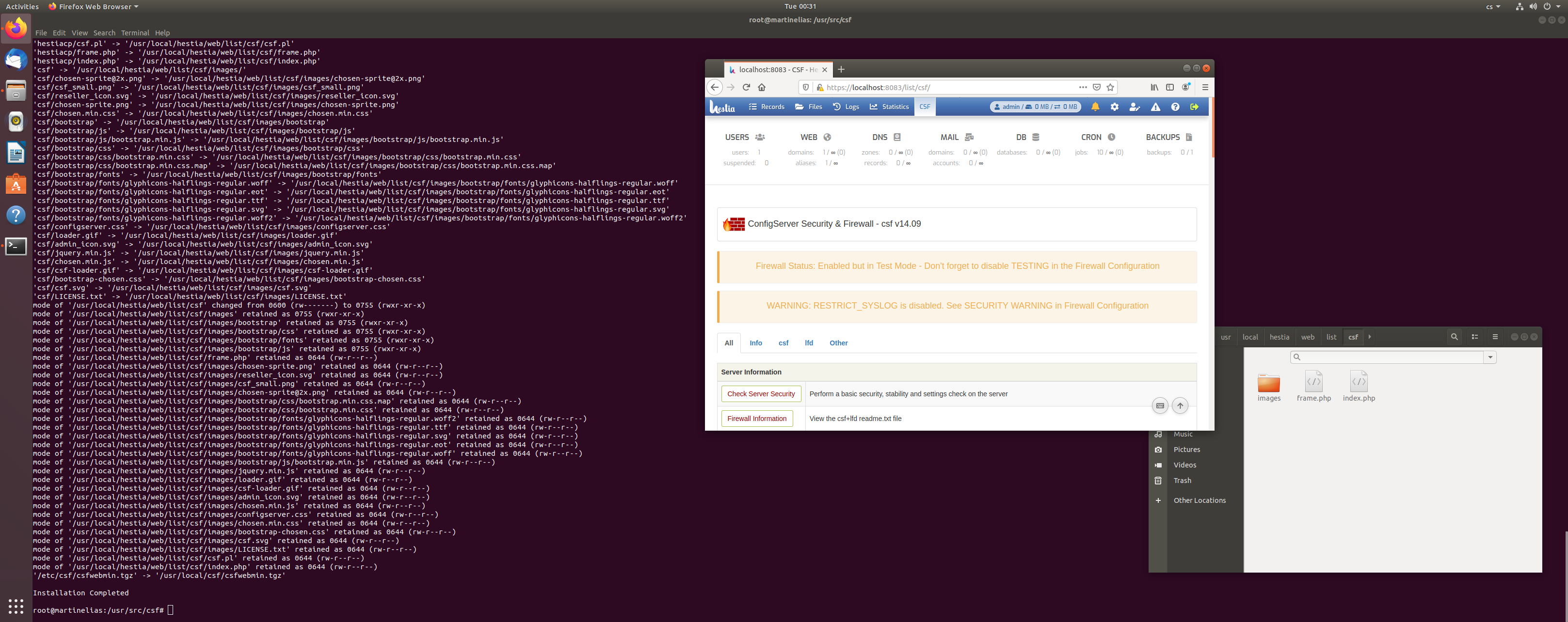

Later I disable test mode, and fix and restrict_syslog warnings. All fine. But then it says its stopped so I choose start csf+ldf and then server hangs completely.
The screen dump above is done before installing csf (after a restore), so the existing csf element is not there. I assume it’s installed after the csf install.sh. And then when I later edit this file there is already an old version formatted csf element there. I have to replace that one, with 1. <div class="l-menu__item <?php if($TAB == 'CSF' ) echo 'l-menu__item--active' ?>"><a href="/list/csf/"><?=__('CSF')?></a></div>. Then the menu works (se picture below).
Then i fix the test warning and syslog warning, and restart the service. Then all hangs.
Error 500 shows it to me when I try to enter the panel wherever it is, not when I try to enter the CSF, which also shows it to me.

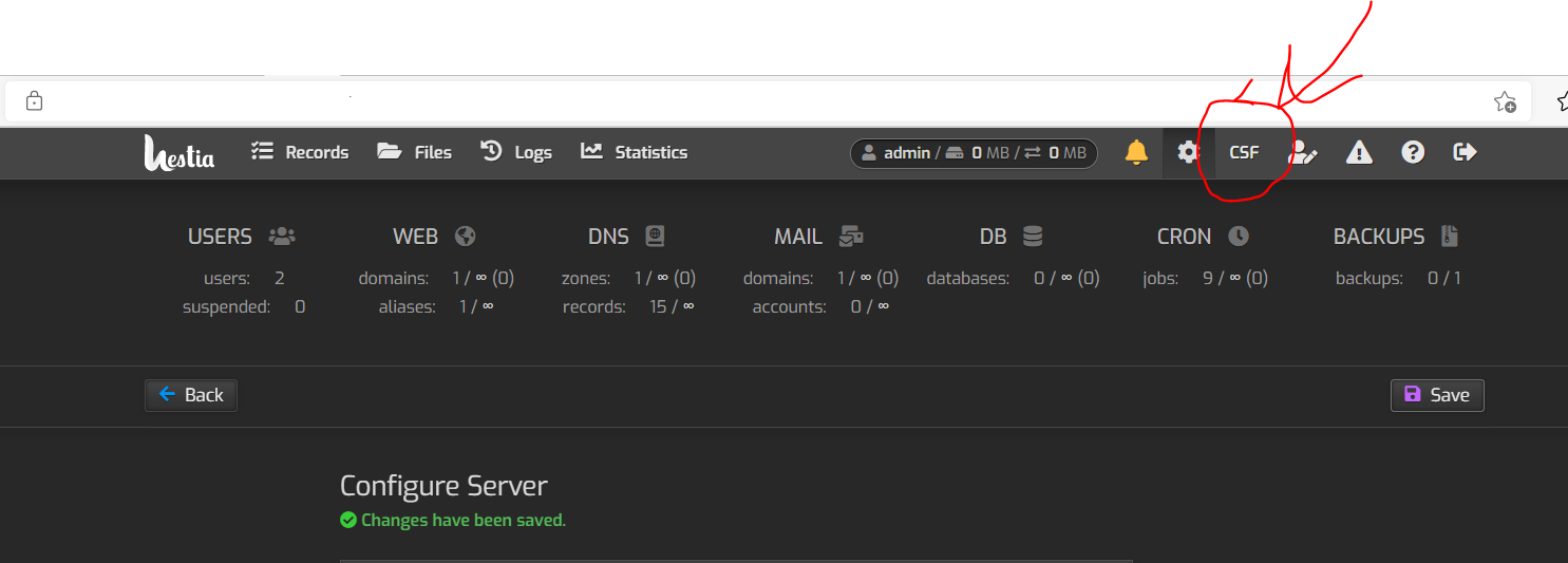

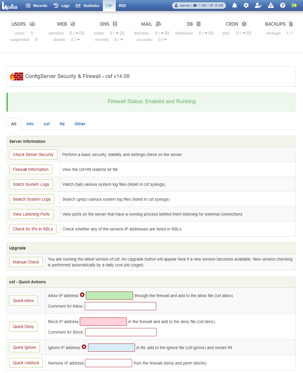

I can see that “CSF” menu item is in the left part, near statistics on your HestiaCP. On my HestiaCp and with your instructions on changing the /usr/local/hestia/web/templates/admin/panel.html, my CSF menu item is turning up on the right side menu part, near the cogg-wheel. So our panel.html is not the same, I assume!? Maybe we have different versions of HestiaCP? I have version v1.3.5 running on Ubuntu 20.04.2 LTS.
As I’ve pointed out earlier in this thread, your instructions on chaning the panel.html does not quite add up with my version of panel.html ([How-to] CSF Support in Hestia CP - #90 by clyde).
If I add CSF to the same left hand menu item group as you have, i get a html page not found error later. But when I place it in the right hand side menu item group beside the cogg-wheel, it works and loads, but a bit later everything freezes.

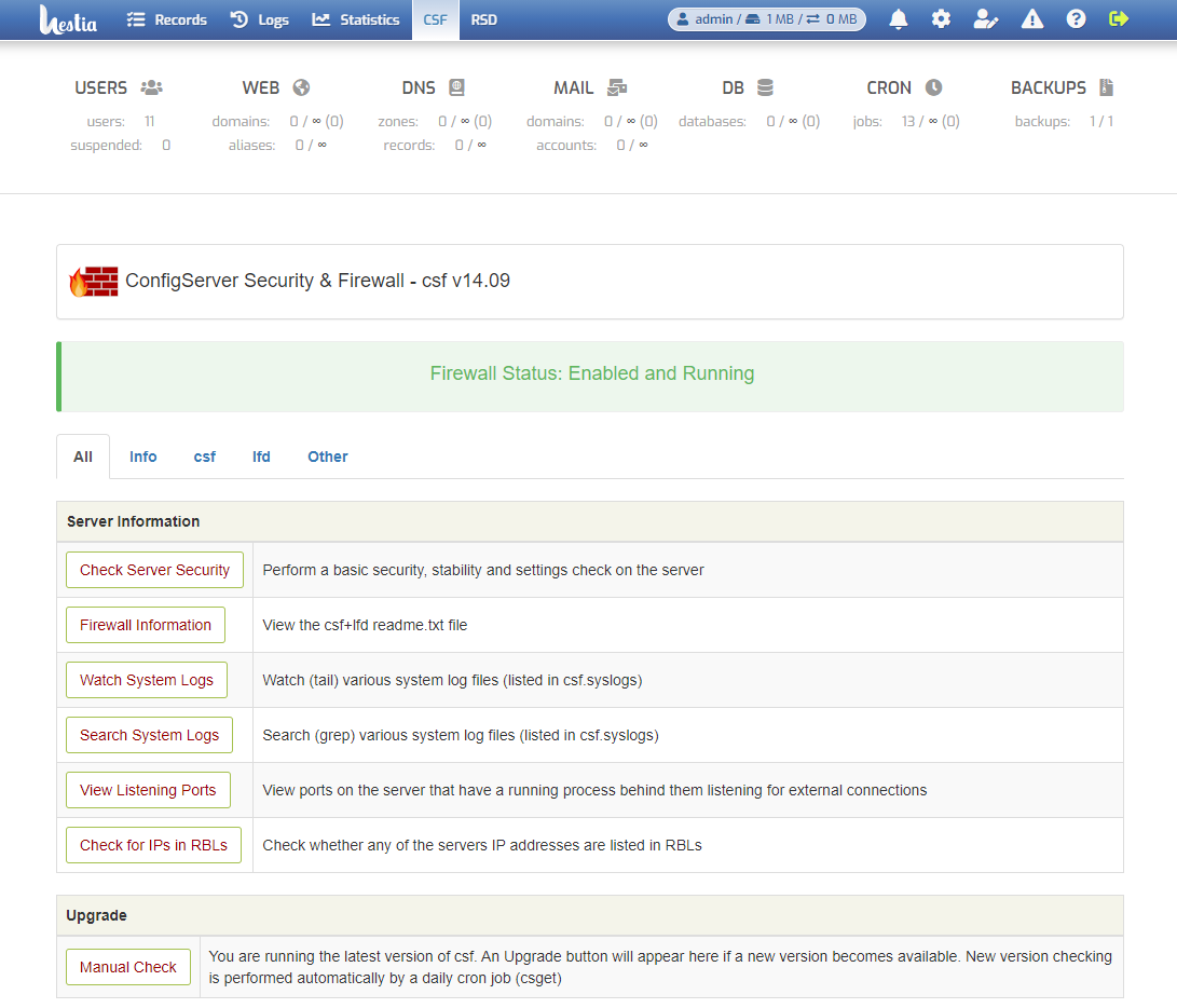

the location of the panel.html file in 1.4.3 is:
/usr/local/hestia/web/templates/includes/panel.html
adding the same code in the correct place (after line 29 as the code is atm) does the trick:
<div class="l-menu__item <?php if($TAB == 'CSF' ) echo 'l-menu__item--active' ?>"><a href="/list/csf/"><?=_('CSF')?></a></div>
If you place it like that the CSF link will show right next to the Statistics link.
