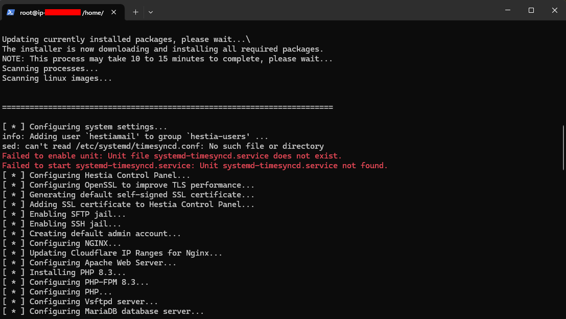

First of all, I would like to thank you for this executable script so that I could test it here on ubuntu 24.04 on my Amazon AWS EC2 server.
The control panel and the website worked fine at first, but there was a message which I don’t know if it could lead to any future problems.
I leave this information here for possible discussions.
Edit:
I found this information on the forum and then installed it on ubuntu:
apt install systemd-timesyncd
It really seems that ubuntu 24.04 and not even Amazon 22.04 have this feature installed.
I don’t know if a later installation will solve the problem or if I’ll have to install hestia again.

I would suggest that if timesyncd is required then it needs to go on a pre-requisite list or be added to the list of packages hestia downloads when you install it.
@tucano2000 I assume you are not running live workloads on this server as it’s beta… so it would probably be good for the community and for the dev team if you could create a clean server, install timesyncd then install hestia and see if that resolves the issue.

@garethw I installed it on clean, newly-created server instances, both on 24.04 and 22.04, just running the apt update and apt upgrade commands before installation to make sure that before installing Hestia, the latest versions of the Ubuntu packages were up to date.
My reply was kinda in response to this bit. Personally I’d wipe the server, update package repos and packages, install timesyncd then re-try the Hestia install to see if it works without error this time.
That way you have a known good system (with the “it’s beta” caveat.) and the team know that installing timesyncd probably needs to be a pre-requisite. Unless you are happy to go edit the installer, put it in yourself and then issue a patch / pull (I’ve not looked at how the project does colaboration stuff)
I made a script sh to test and install systemd-timesyncd:
test_timesynd.sh
if ! systemctl is-active --quiet systemd-timesyncd 2>/dev/null; then
    echo “ - Installing service systemd-timesyncd”
    DEBIAN_FRONTEND=noninteractive apt install -y systemd-timesyncd
else
    echo “ - Service systemd-timesyncd already installed”
fi
I had to add the command DEBIAN_FRONTEND=noninteractive to the line of code to avoid the system prompt that warns about updating the kernel.
I think that’s why they didn’t include a system message in the package that takes up the whole screen and stops the installation process.
In any case, for Debian systems it could be used in this way in the official installation script.
