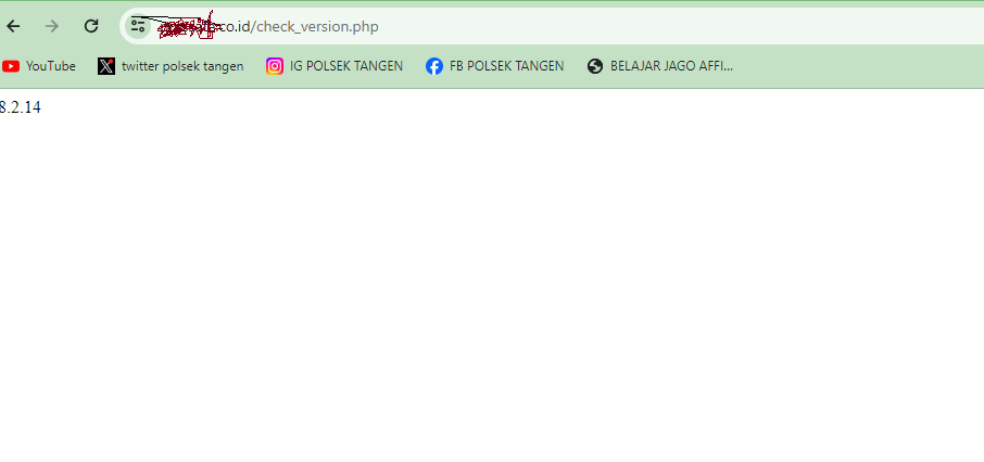

It turns out I’m still using version 8.2 PHP even though I’ve changed the settings in the user configuration to 7.4

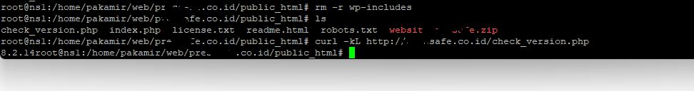

need solution about this problem, what must i have to do … to solve this problem ? because still on 8.2 after i check php version as sama as your guidance

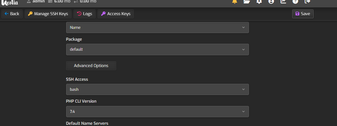

although i have changed php version to 7.4 on user configuration, as my picture above

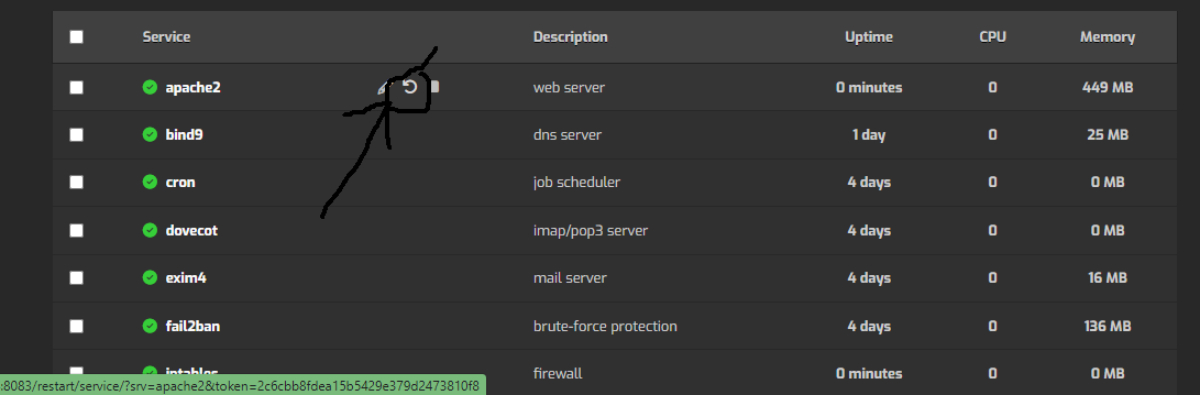

after chnage php version i also have restarted this… but php version in my website still 8.2
This is for CLI only for the admin user… Any other user will still run under the default version of the system.,…

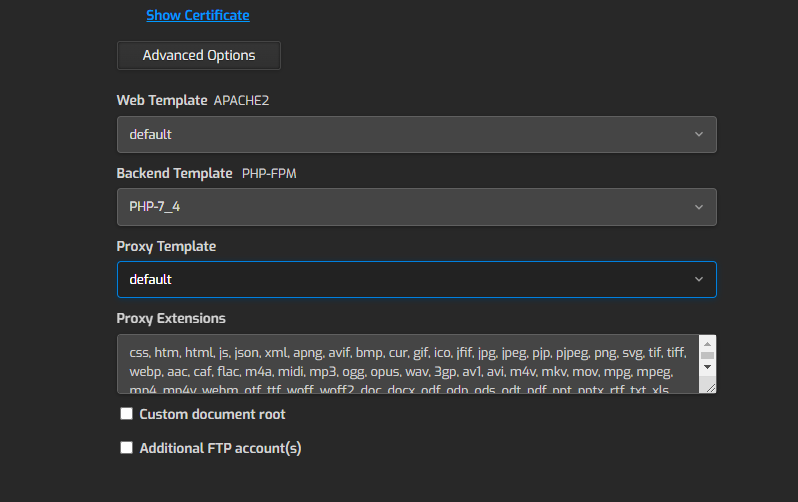

No, it means that you must edit your domain and in advanced options select PHP-7_4 as Backend Template.

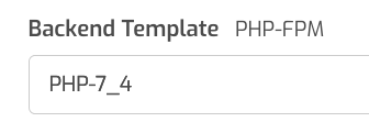

just edit this, is it right ? or still have to make some command on terminal ?
Yes, Backend Template as PHP-7_4 and Save, thats all
