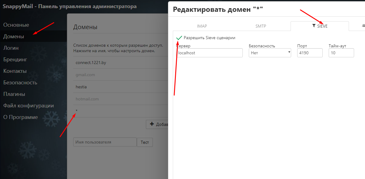

Ok i found it
You need to include them in THIS place as well
This is a admin mode for snappymail
