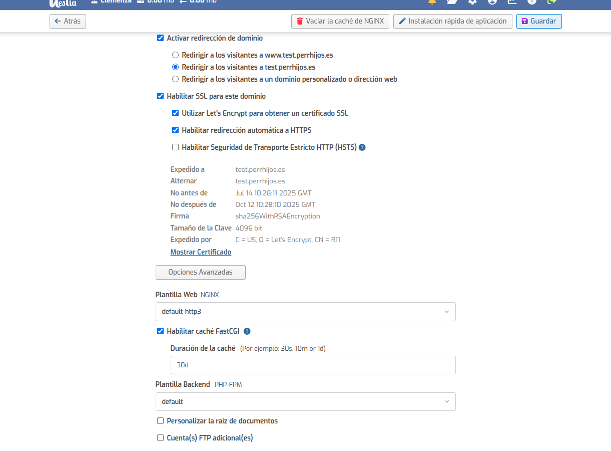

Now I install Wordpress, and http3 stops working. I notice that the template changes itself to “Wordpress”, so I select again the template for http3, but then, the web does not work. Wordpress stops working.

This has worked, but now it does not work, I do not know why.
I have repeated the process again, but it still does not work.

I entered the domain and changed the plan to wordpress-http3
