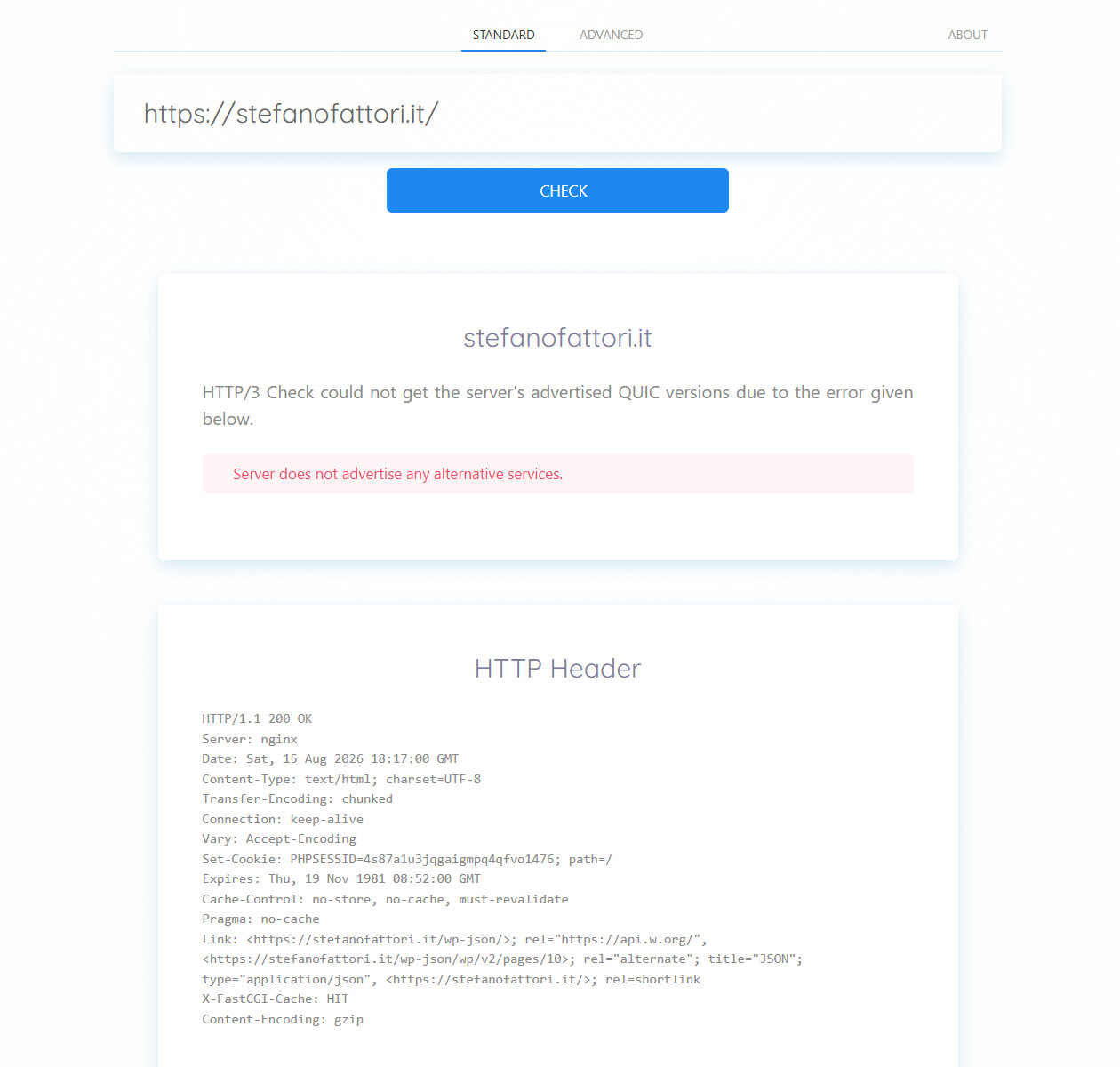

I see it is using HTTP/3:
mmmmh… interesting.

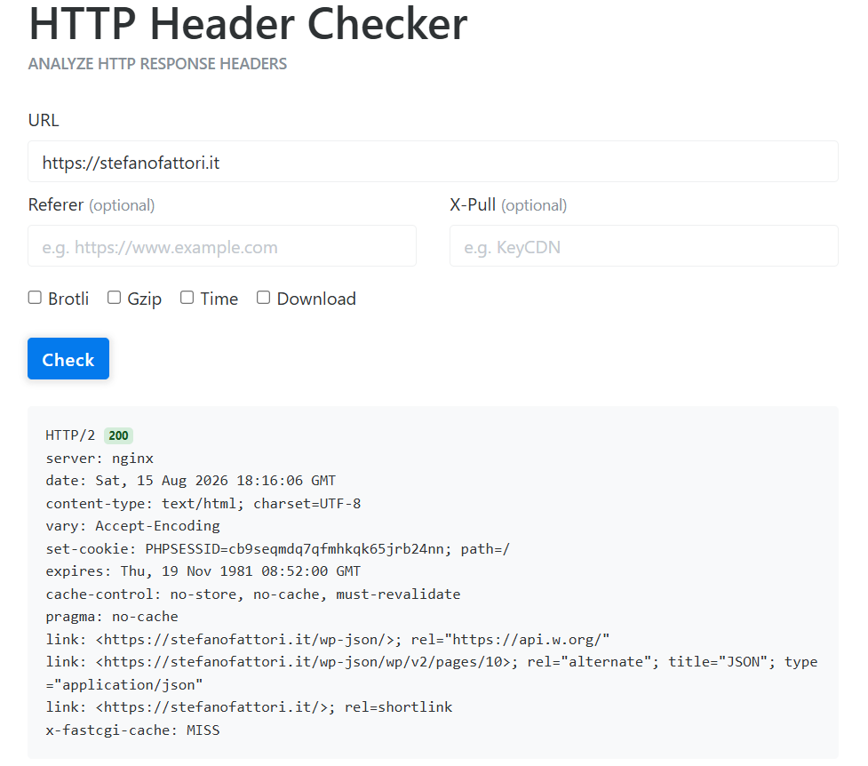

so why here do I can’t see the header Alt-Svc: h3=":443"; ma=86400
and here it says that it doesn’t use http3?
https://http3check.net/
HTTP Header Checker - Check HTTP Response Headers With curl | KeyCDN Tools
thanks
I don’t see the header too but it answers using HTTP/3
❯ curl-ech -IkL --http3 https://stefanofattori.it/
HTTP/3 200
server: nginx
date: Sat, 15 Aug 2026 18:22:43 GMT
content-type: text/html; charset=UTF-8
vary: accept-encoding
set-cookie: PHPSESSID=cb9seqmdq7qfmhkqk65jrb24nn; path=/
expires: Thu, 19 Nov 1981 08:52:00 GMT
cache-control: no-store, no-cache, must-revalidate
pragma: no-cache
link: <https://stefanofattori.it/wp-json/>; rel="https://api.w.org/"
link: <https://stefanofattori.it/wp-json/wp/v2/pages/10>; rel="alternate"; title="JSON"; type="application/json"
link: <https://stefanofattori.it/>; rel=shortlink
x-fastcgi-cache: HIT

Ok, I missed this in the curl output:
Looks like you added an add_header directive in a location block. If that’s the case, Nginx is removing the header added in the server block. Remove that header, or add the Alt-Svc header to the location where you added the X-FastCGI-Cache header.
