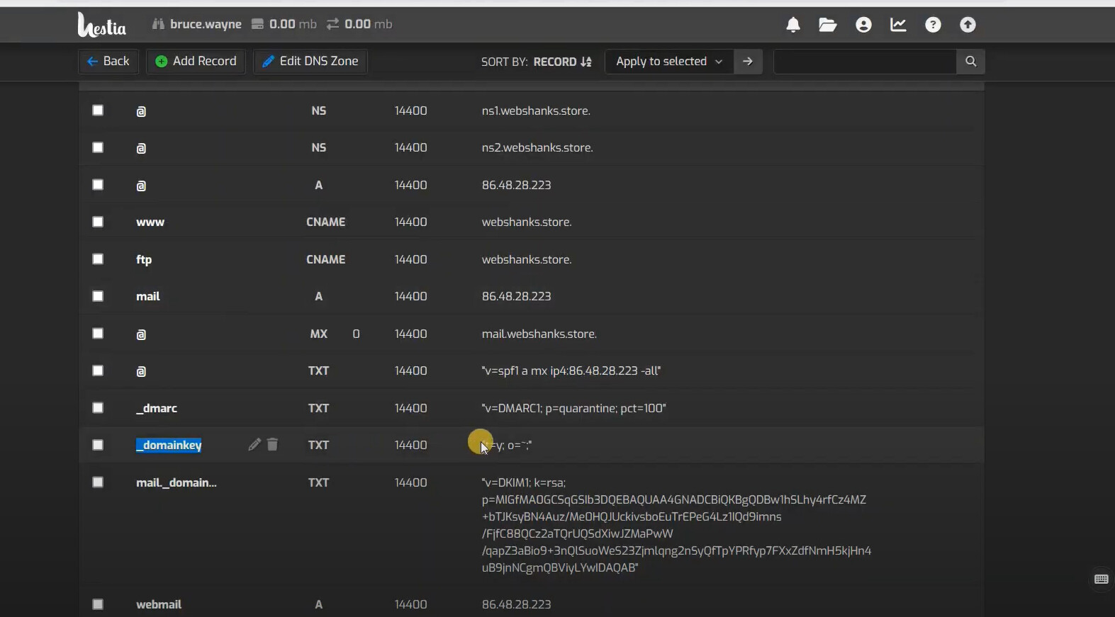

The person showing that has -domainkey, currently mine doesn’t have that.

_domankey is a deprecated record so you don’t need it but you must have mail._domainkey record.

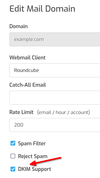

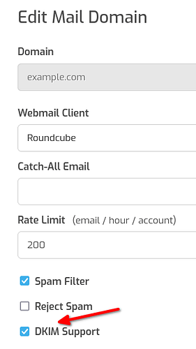

Did you select DKIM support option when adding the mail domain? Edit the mail domain and if you didn’t select DKIM then select it and save.

I have ticked DKIM support.

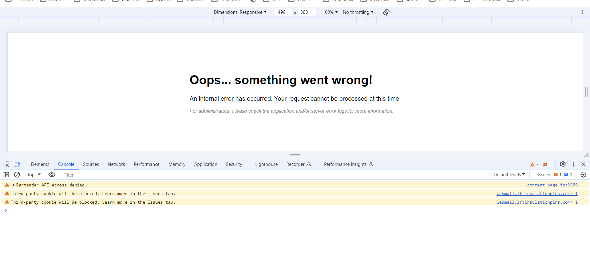

When I access http://webmail.mydomain.com/ , it returned the error.

That’s because a bug, to fix it:
chown -R hestiamail:www-data /etc/roundcube/
find /etc/roundcube/ -type f -iname "*php" -exec chmod 640 {} \;
chown -R hestiamail:www-data /var/lib/roundcube/
chown -R hestiamail:www-data /var/log/roundcube/

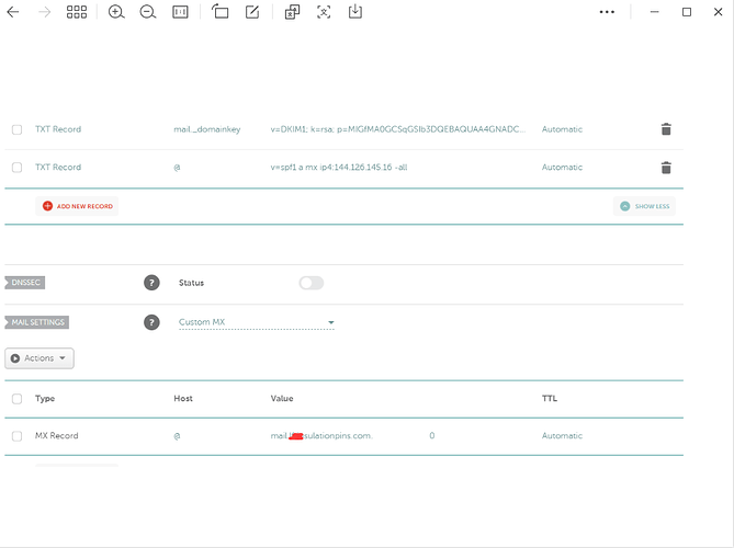

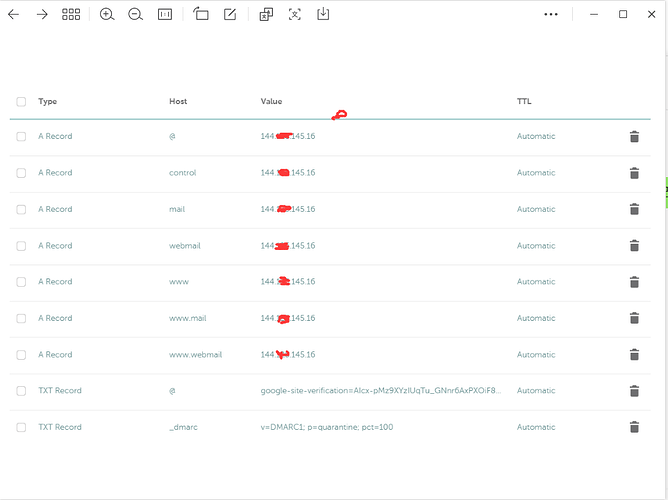

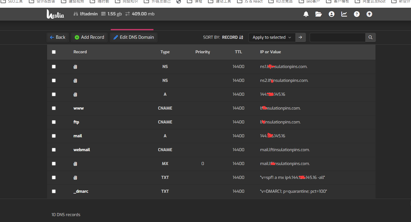

What record should I add? I will give you a screenshot, please help?

I’ve checked it now and seems you already added all the needed records in Namecheap DNS Servers.

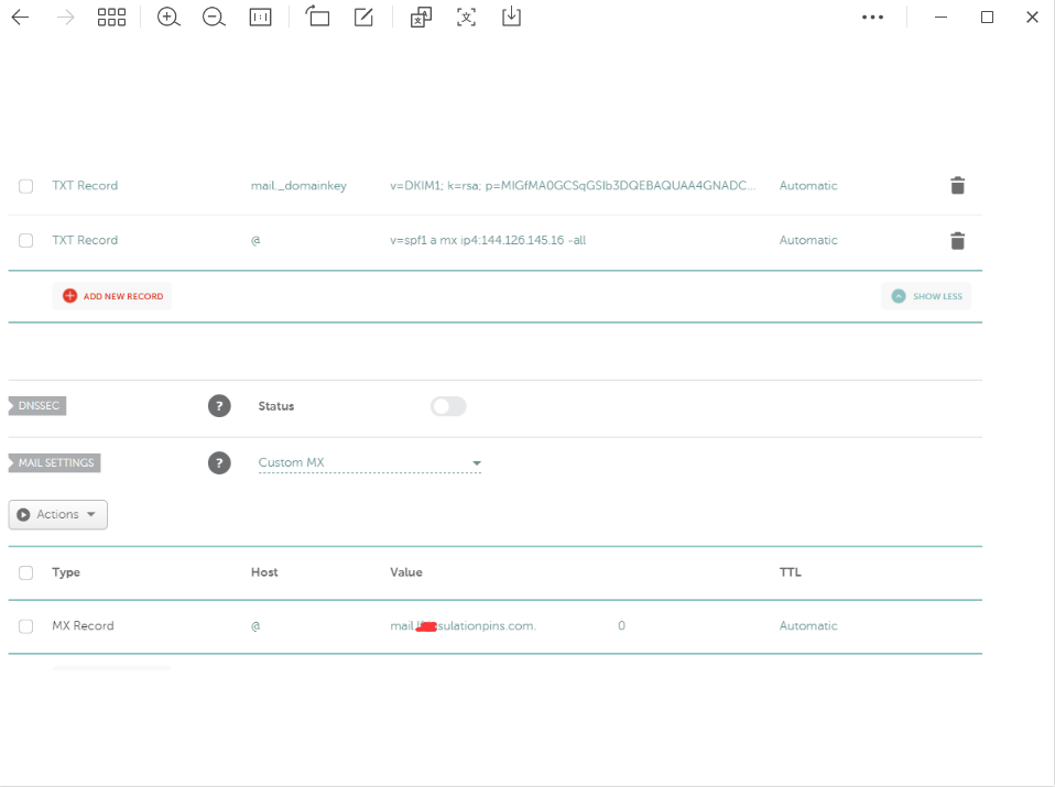

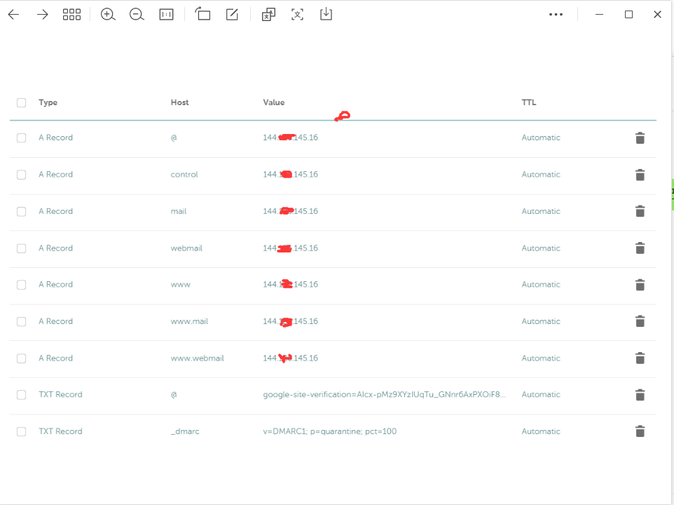

These are all the dns records I added.
Is there anything wrong or I missed anything?

All ok, well, you shouldn’t need www.mail and www.webmail but it won’t hurt.
As root.
