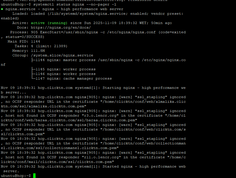

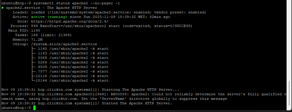

systemctl status nginx --no-pager -l
systemctl status apache2 --no-pager -l

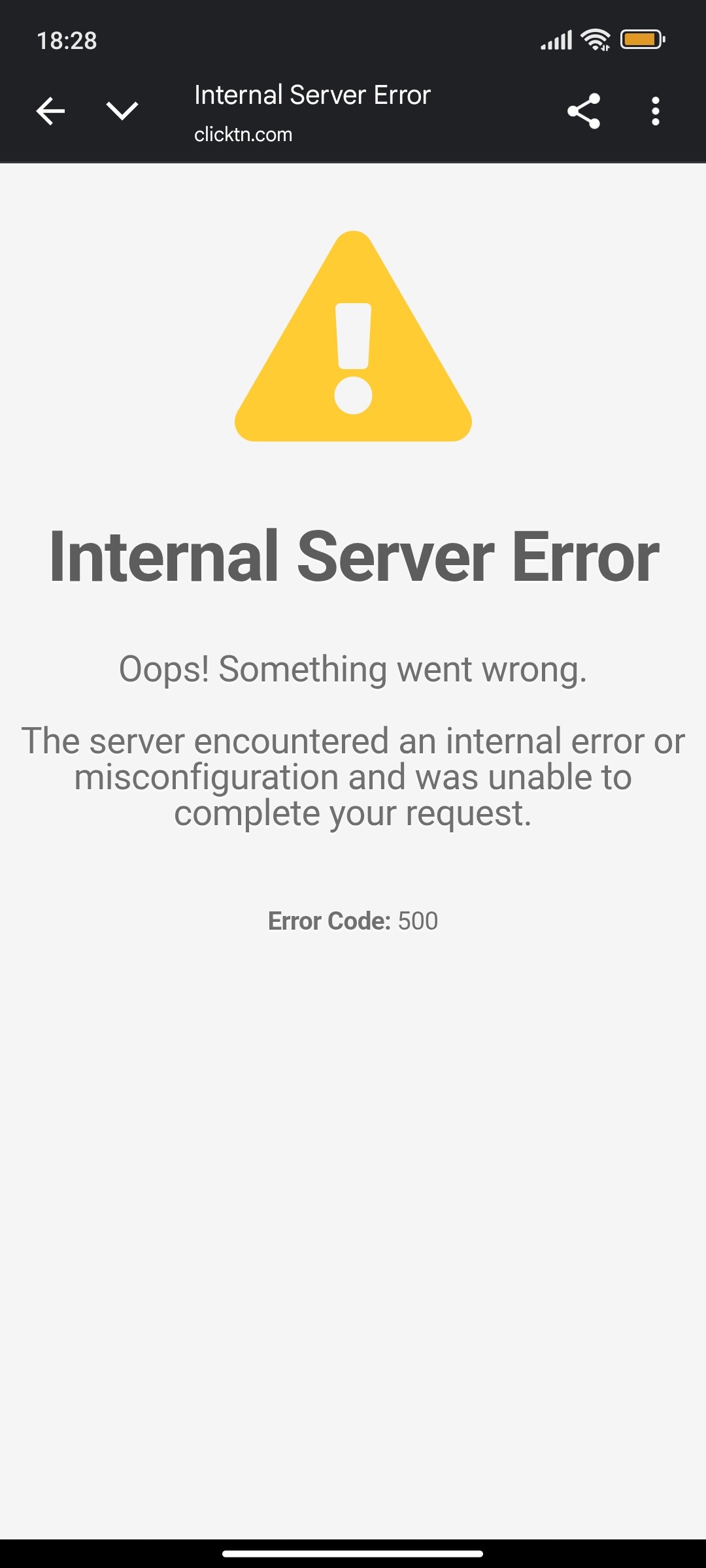

Thank you for your response, but the problem is with the server. The system works for a while, then reverts to error 500. I’ve tried restarting it several times, but to no avail. Thank you for your response, but the problem is with the server. The system works for a while, then reverts to error 500. I’ve tried restarting it several times, but to no avail.

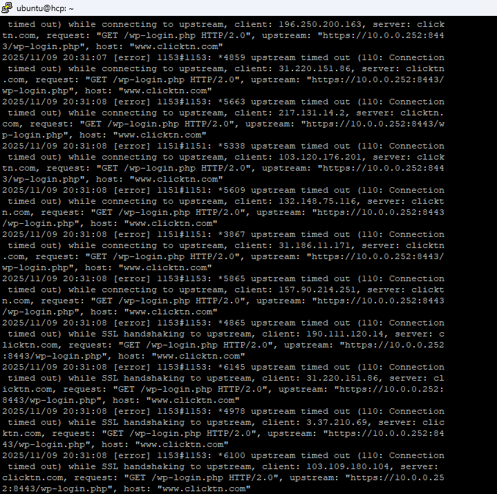

Ok, if it works for a while, check the log to know what happens when it gives error 5xx.
The log should be here: /var/log/apache2/domains/clicktn.com.error.log

Status for both, nginx and apache2 is ok.

Reproduce the 5xx error and just after that:
tail -n50 /var/log/apache2/domains/clicktn.com.error.log

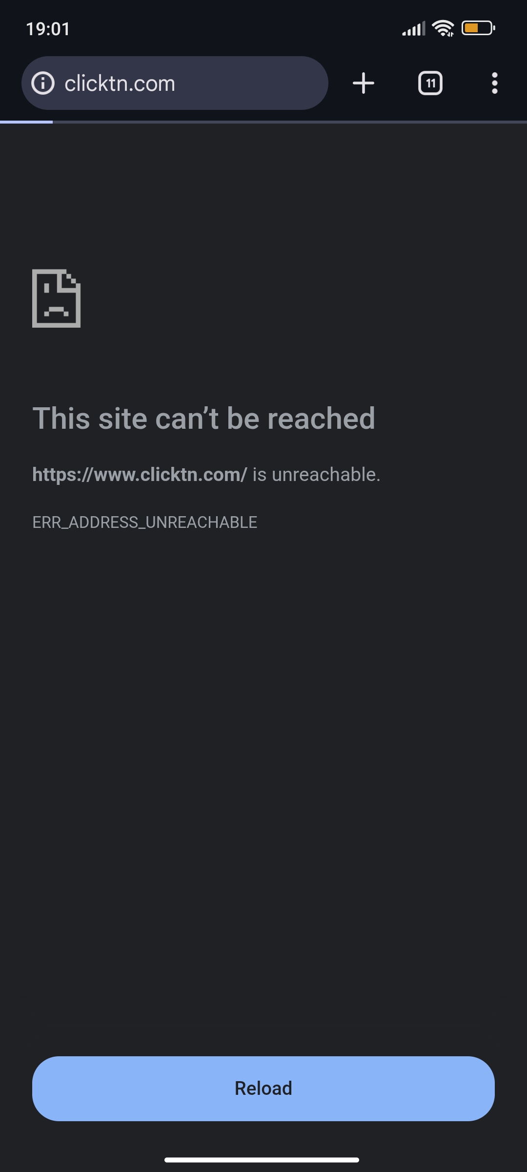

Unfortunately, the website is no longer working.
until CP It won’t open even though it was working yesterday.
