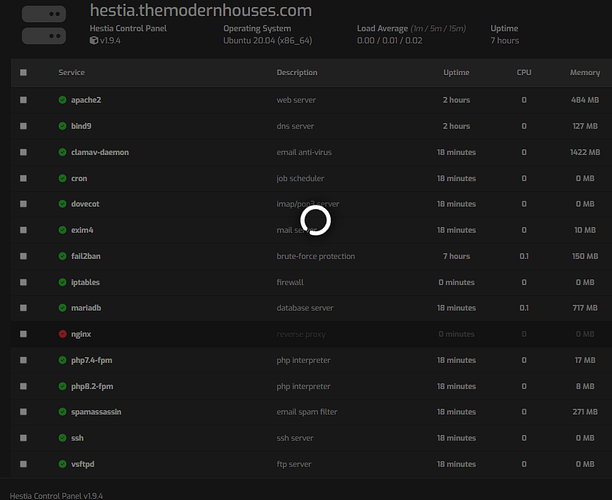

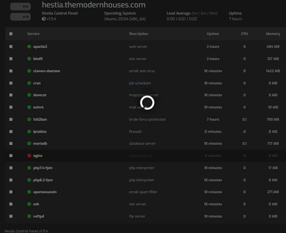

I restarted my Contabo VPS server, and now all websites are not working. I have a Hestia control panel installed
I restarted my Contabo VPS server, and now all websites are not working. I have a Hestia control panel installed. can u help please

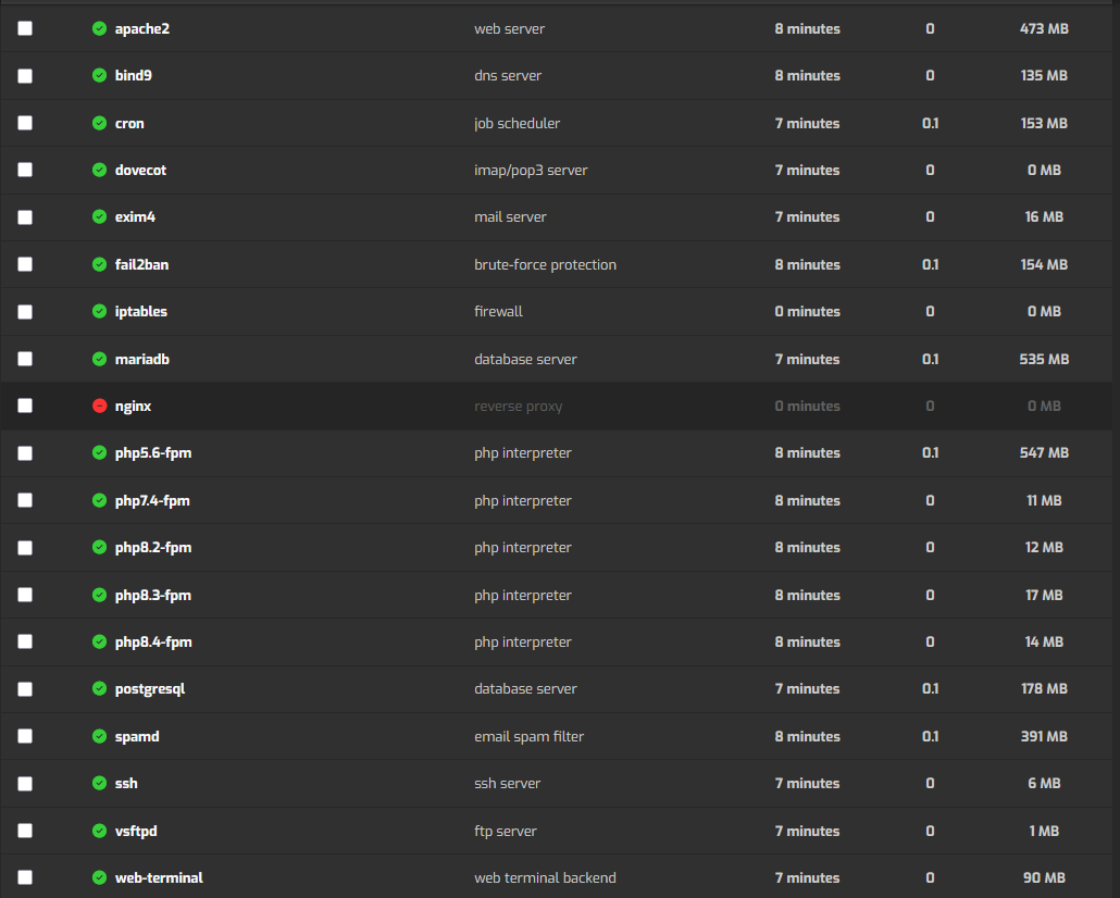

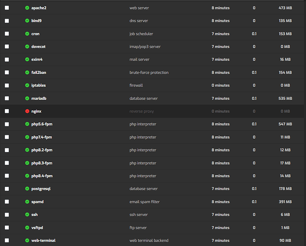

same happened with me, my VPS is also on Contabo and when i updated vps via apt update and upgrade and then reboot after that all websites not running because i can login to panel and check there is nginx is not running (failed), manually start nginx did not succeed. whats wrong guys?
Debian 12, Hestia 1.9.4
cannot start nginx

first of all, ubuntu 20.04 isnt supported anymore by hestia and sury repository, you’ll need to upgrade to 22.04 at least - but as you do not know, how to check the nginx service status (systemctl status nginx), it’s probaly not a good idea to run it on your own; please see Read This First: Important Notes for Running HestiaCP Safely and How can the server be upgraded without these errors? - #23 by Raphael
Please get yourself help from a sysadmin, this is out of the spectrum and idea behind this forum.
