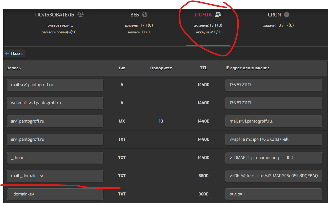

Lets say, we are using subdomain srv1.XXX.ru for the mail:
The DKIM record for srv1.XXX.ru should be mail._domainkey.srv1, but it is mail._domainkey in HestiaCP:

But you are assuming that subdomain.domain.tld is not an independent zone and it is part of domain.tld and it is not (or at least couldn’t be).
So, in your screenshot, mail._domainkey will be translated to mail._domainkey.subdomain.domain.tld but if you add mail._domainkey.subdomain it will translate to mail._domainkey.subdomain.subdomain.domain.tld which is wrong.
In my case subdomain.domain.tld and domain.tld are two independent zones and belongs to different hestia users. All other DNS records created in right way with using subdomain, but not DKIM record.
It depends if you add it to the sub.domain.com zone of domain.com zone
Assuming the the first it should be correct…
Guys, maybe I’m wrong and Hestia is creating the records correctly, but I see in the screenshot above that the DKM for subdomains doesn’t match the recommendations. Or the record is not created at all for subdomain.

There are all talking to add them to the domain.com zone in that case it is correct you should use:
But when you add tot he
subdomain.domain.com zone it should be:
mail._domainkey
Assuming we don’t know how a user is going to use the DNS how the hell are we supposed to know what we should display…
I think that if subdomain.domain.tld is created as a mail domain in Hestia, the DKIM DNS should be mail._domainkey.subdomain anyway
It depends if you use subdomain.domain.com or domain.com as zone…
I think it is hard to know the difference for us… What a user is going to use …

Did you have created a DNS zone for subdomain.domain.tld
I just wanted to use my own server with the Hestia panel as an ns server and thought Hestia creates the correct DNS records automatically.
If I create records on a 3rd party DNS provider manually, then of course I create DNS zones for each domain/subdomain.
It you add the DNS zone for sub.domain.com the DNS creates them correctly…
I didn’t create anything manually on the server, just used the panel to create a web server and a mail server independent for the domain and subdomain.
By now we create all DNS records with the domain name registrar, but we have been tasked to use our own NS servers with Hestia.
This is where I saw that visually the DKIM records in Hestia are not created correctly.
Then again, maybe it’s all visual and the records themselves are correct. Sorry for that.
Then setup the name servers first…
DNS records under the mail tab are only for info… Not used for DNS …
