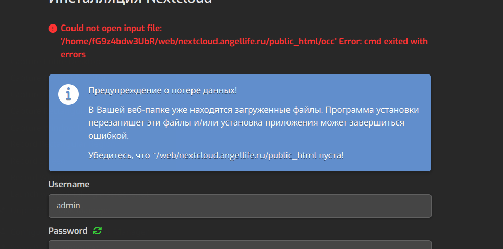

Hello everyone, I install Nextcloud I get this error
  1. Could not open input file: ‘/home/fG9z4bdw3UbR/web/nextcloud.angellife.ru/public_html/occ’ Error: cmd exited with errors. Data loss warning!
    Your web folder already contains uploaded files. The installer will overwrite these files and / or the application installation may fail.
    Make sure that ~ / web/nextcloud. angellife. com/public_html is empty!

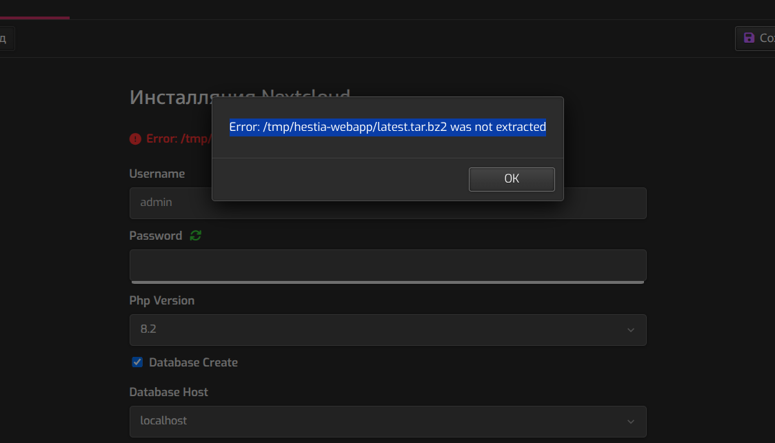

  2. Error: /tmp/hestia-webapp/latest.tar.bz2 was not extracted

  6. I got error # 2 once

It doesn’t work (, error
Could not open input file: ‘/home/jrotgpvnqgswaaudskscia/web/nextcloud.angellife.ru/public_html/occ’ Error: cmd exited with errors

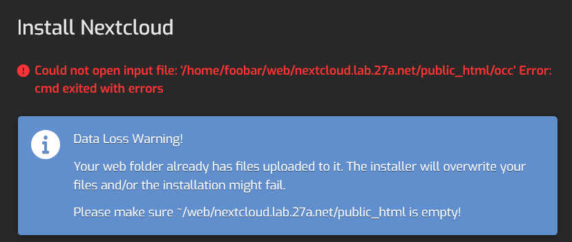

I tried it on a fresh Debian 12, Hestia 1.9.3, only Nginx and PHP-FPM:
❯ curl -fsSLm15 https://7j.gg/hcpver | bash -s --
Software            Version
OS             Debian 12.11
Hestia                1.9.3
Hestia-nginx         1.27.4
Hestia-php           8.3.17
FileGator            7.13.0
Nginx                1.27.5
PHP8.4                8.4.7
PHP8.3               8.3.21
PHP8.2               8.2.28
PHP8.1               8.1.32
PHP8.0               8.0.30
PHP7.4               7.4.33
Awstats                 7.8
Exim4                  4.96
Dovecot            2.3.19.1
Dovecot-sieve      2.3.19.1
Spamassassin          4.0.1
Roundcube            1.6.10
Vsftpd                3.0.3
Bind9               9.18.33
Mariadb              11.4.7
phpMyAdmin            5.2.2
Fail2ban              1.0.2
And here the error:
Now I’ve applied the fix:
sudo -i
cd /usr/local/hestia/web/src/app/WebApp/Installers/Nextcloud/
mv NextcloudSetup.php NextcloudSetup.php.ori
curl -fsSLm15 https://7j.gg/ncpatch -o NextcloudSetup.php
rm -rf /home/foobar/web/YourDomain/public_html/*
rm -rf /home/foobar/web/YourDomain/public_html/.*
rm -rf /tmp/hestia-webapp
And tried to install again:

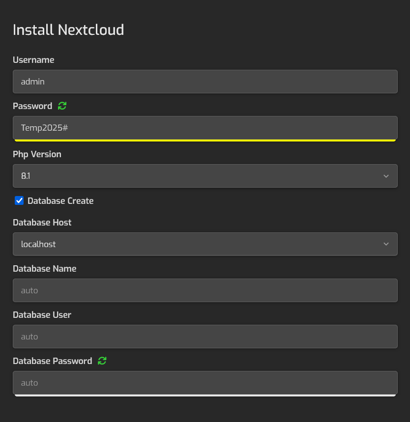

I think you copied and pasted these four commands at the same time and it didn’t replaced the old NextcloudSetup.php
sudo -i
Execute the commands one by one, double check that the md5sum of the new file is this:
❯ md5sum /usr/local/hestia/web/src/app/WebApp/Installers/Nextcloud/NextcloudSetup.php
82abe6c94ab4d6c60393f911e5f90df0  /usr/local/hestia/web/src/app/WebApp/Installers/Nextcloud/NextcloudSetup.php
Also, NextCloud needs PHP 8.1, 8.2, 8.3 or 8.4 but it recommends 8.3. I’ve installed it using PHP 8.1.
Hooray I installed)
sudo -i bash -c "cd /usr/local/hestia/web/src/app/WebApp/Installers/Nextcloud/ && mv NextcloudSetup.php NextcloudSetup.php.ori && curl -fsSLm15 https://7j.gg/ncpatch -o NextcloudSetup.php && rm -rf /home/admin/web/nextcloud.example.com/public_html/* && rm -rf /home/admin/web/nextcloud.example.com/public_html/.* && rm -rf /tmp/hestia-webapp/"
Changing admin and nextcloud.example.com, we launch it simply in “one click”.

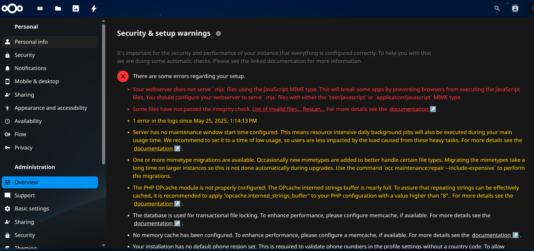

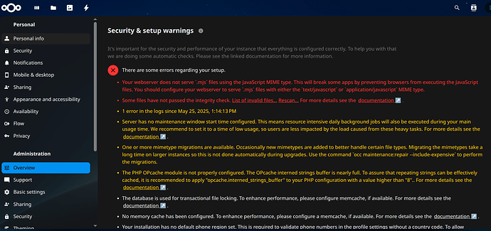

Hello, sorry to draw your attention, I tested several installations on Debian 12 and Ubuntu 24.04, but everywhere I got a lot of errors after installation, mainly related to PHP, as well as a HASH error, like this. As I can see you used a download from your file storage cd /usr/local/hestia/web/src/app/WebApp/Installers/Nextcloud/ && mv NextcloudSetup.php NextcloudSetup.php.ori && curl -fsSLm15 https://7j.gg/ncpatch -o NextcloudSetup.php
Could this be something to do with these errors? Thanks
Configuration errors were detected.
Your web server does not serve`. mjs ' files using the JavaScript MIME type. This will disrupt some applications by preventing browsers from executing JavaScript files. You should configure the web server to serve'. mjs 'files with the MIME type' text/javascript 'or`application/javascript'.
An exception occured while running the setup check: PDOException: SQLSTATE[HY000]: General error: 2006 MySQL server has gone away in /home/yzfyqocpxmdiaigyhyfaqy/web/nextcloud.angellife.ru/public_html/3rdparty/doctrine/dbal/src/Driver/PDO/Connection.php:71 Stack trace: #0 /home/yzfyqocpxmdiaigyhyfaqy/web/nextcloud.angellife.ru/public_html/3rdparty/doctrine/dbal/src/Driver/PDO/Connection.php(71): PDO->query() #1 /home/yzfyqocpxmdiaigyhyfaqy/web/nextcloud.angellife.ru/public_html/3rdparty/doctrine/dbal/src/Connection.php(1106): Doctrine\DBAL\Driver\PDO\Connection->query() #2 /home/yzfyqocpxmdiaigyhyfaqy/web/nextcloud.angellife.ru/public_html/lib/private/DB/Connection.php(419): Doctrine\DBAL\Connection->executeQuery() #3 /home/yzfyqocpxmdiaigyhyfaqy/web/nextcloud.angellife.ru/public_html/3rdparty/doctrine/dbal/src/Connection.php(627): OC\DB\Connection->executeQuery() #4 /home/yzfyqocpxmdiaigyhyfaqy/web/nextcloud.angellife.ru/public_html/3rdparty/doctrine/dbal/src/Connection.php(267): Doctrine\DBAL\Connection->fetchOne() #5 /home/yzfyqocpxmdiaigyhyfaqy/web/nextcloud.angellife.ru/public_html/3rdparty/doctrine/dbal/src/Schema/AbstractSchemaManager.php(1778): Doctrine\DBAL\Connection->getDatabase() #6 /home/yzfyqocpxmdiaigyhyfaqy/web/nextcloud.angellife.ru/public_html/3rdparty/doctrine/dbal/src/Schema/AbstractSchemaManager.php(406): Doctrine\DBAL\Schema\AbstractSchemaManager->getDatabase() #7 /home/yzfyqocpxmdiaigyhyfaqy/web/nextcloud.angellife.ru/public_html/3rdparty/doctrine/dbal/src/Schema/MySQLSchemaManager.php(66): Doctrine\DBAL\Schema\AbstractSchemaManager->doListTables() #8 /home/yzfyqocpxmdiaigyhyfaqy/web/nextcloud.angellife.ru/public_html/3rdparty/doctrine/dbal/src/Schema/AbstractSchemaManager.php(1651): Doctrine\DBAL\Schema\MySQLSchemaManager->listTables() #9 /home/yzfyqocpxmdiaigyhyfaqy/web/nextcloud.angellife.ru/public_html/3rdparty/doctrine/dbal/src/Schema/AbstractSchemaManager.php(1663): Doctrine\DBAL\Schema\AbstractSchemaManager->createSchema() #10 /home/yzfyqocpxmdiaigyhyfaqy/web/nextcloud.angellife.ru/public_html/lib/private/DB/Migrator.php(77): Doctrine\DBAL\Schema\AbstractSchemaManager->introspectSchema() #11 /home/yzfyqocpxmdiaigyhyfaqy/web/nextcloud.angellife.ru/public_html/lib/private/DB/Connection.php(776): OC\DB\Migrator->createSchema() #12 /home/yzfyqocpxmdiaigyhyfaqy/web/nextcloud.angellife.ru/public_html/lib/private/DB/SchemaWrapper.php(28): OC\DB\Connection->createSchema() #13 /home/yzfyqocpxmdiaigyhyfaqy/web/nextcloud.angellife.ru/public_html/apps/settings/lib/SetupChecks/DatabaseHasMissingIndices.php(47): OC\DB\SchemaWrapper->__construct() #14 /home/yzfyqocpxmdiaigyhyfaqy/web/nextcloud.angellife.ru/public_html/apps/settings/lib/SetupChecks/DatabaseHasMissingIndices.php(74): OCA\Settings\SetupChecks\DatabaseHasMissingIndices->getMissingIndices() #15 /home/yzfyqocpxmdiaigyhyfaqy/web/nextcloud.angellife.ru/public_html/lib/private/SetupCheck/SetupCheckManager.php(34): OCA\Settings\SetupChecks\DatabaseHasMissingIndices->run() #16 /home/yzfyqocpxmdiaigyhyfaqy/web/nextcloud.angellife.ru/public_html/apps/settings/lib/Controller/CheckSetupController.php(134): OC\SetupCheck\SetupCheckManager->runAll() #17 /home/yzfyqocpxmdiaigyhyfaqy/web/nextcloud.angellife.ru/public_html/lib/private/AppFramework/Http/Dispatcher.php(200): OCA\Settings\Controller\CheckSetupController->check() #18 /home/yzfyqocpxmdiaigyhyfaqy/web/nextcloud.angellife.ru/public_html/lib/private/AppFramework/Http/Dispatcher.php(114): OC\AppFramework\Http\Dispatcher->executeController() #19 /home/yzfyqocpxmdiaigyhyfaqy/web/nextcloud.angellife.ru/public_html/lib/private/AppFramework/App.php(161): OC\AppFramework\Http\Dispatcher->dispatch() #20 /home/yzfyqocpxmdiaigyhyfaqy/web/nextcloud.angellife.ru/public_html/lib/private/Route/Router.php(307): OC\AppFramework\App::main() #21 /home/yzfyqocpxmdiaigyhyfaqy/web/nextcloud.angellife.ru/public_html/lib/base.php(1040): OC\Route\Router->match() #22 /home/yzfyqocpxmdiaigyhyfaqy/web/nextcloud.angellife.ru/public_html/index.php(24): OC::handleRequest() #23 {main} Next Doctrine\DBAL\Driver\PDO\Exception: SQLSTATE[HY000]: General error: 2006 MySQL server has gone away in /home/yzfyqocpxmdiaigyhyfaqy/web/nextcloud.angellife.ru/public_html/3rdparty/doctrine/dbal/src/Driver/PDO/Exception.php:24 Stack trace: #0 /home/yzfyqocpxmdiaigyhyfaqy/web/nextcloud.angellife.ru/public_html/3rdparty/doctrine/dbal/src/Driver/PDO/Connection.php(76): Doctrine\DBAL\Driver\PDO\Exception::new() #1 /home/yzfyqocpxmdiaigyhyfaqy/web/nextcloud.angellife.ru/public_html/3rdparty/doctrine/dbal/src/Connection.php(1106): Doctrine\DBAL\Driver\PDO\Connection->query() #2 /home/yzfyqocpxmdiaigyhyfaqy/web/nextcloud.angellife.ru/public_html/lib/private/DB/Connection.php(419): Doctrine\DBAL\Connection->executeQuery() #3 /home/yzfyqocpxmdiaigyhyfaqy/web/nextcloud.angellife.ru/public_html/3rdparty/doctrine/dbal/src/Connection.php(627): OC\DB\Connection->executeQuery() #4 /home/yzfyqocpxmdiaigyhyfaqy/web/nextcloud.angellife.ru/public_html/3rdparty/doctrine/dbal/src/Connection.php(267): Doctrine\DBAL\Connection->fetchOne() #5 /home/yzfyqocpxmdiaigyhyfaqy/web/nextcloud.angellife.ru/public_html/3rdparty/doctrine/dbal/src/Schema/AbstractSchemaManager.php(1778): Doctrine\DBAL\Connection->getDatabase() #6 /home/yzfyqocpxmdiaigyhyfaqy/web/nextcloud.angellife.ru/public_html/3rdparty/doctrine/dbal/src/Schema/AbstractSchemaManager.php(406): Doctrine\DBAL\Schema\AbstractSchemaManager->getDatabase() #7 /home/yzfyqocpxmdiaigyhyfaqy/web/nextcloud.angellife.ru/public_html/3rdparty/doctrine/dbal/src/Schema/MySQLSchemaManager.php(66): Doctrine\DBAL\Schema\AbstractSchemaManager->doListTables() #8 /home/yzfyqocpxmdiaigyhyfaqy/web/nextcloud.angellife.ru/public_html/3rdparty/doctrine/dbal/src/Schema/AbstractSchemaManager.php(1651): Doctrine\DBAL\Schema\MySQLSchemaManager->listTables() #9 /home/yzfyqocpxmdiaigyhyfaqy/web/nextcloud.angellife.ru/public_html/3rdparty/doctrine/dbal/src/Schema/AbstractSchemaManager.php(1663): Doctrine\DBAL\Schema\AbstractSchemaManager->createSchema() #10 /home/yzfyqocpxmdiaigyhyfaqy/web/nextcloud.angellife.ru/public_html/lib/private/DB/Migrator.php(77): Doctrine\DBAL\Schema\AbstractSchemaManager->introspectSchema() #11 /home/yzfyqocpxmdiaigyhyfaqy/web/nextcloud.angellife.ru/public_html/lib/private/DB/Connection.php(776): OC\DB\Migrator->createSchema() #12 /home/yzfyqocpxmdiaigyhyfaqy/web/nextcloud.angellife.ru/public_html/lib/private/DB/SchemaWrapper.php(28): OC\DB\Connection->createSchema() #13 /home/yzfyqocpxmdiaigyhyfaqy/web/nextcloud.angellife.ru/public_html/apps/settings/lib/SetupChecks/DatabaseHasMissingIndices.php(47): OC\DB\SchemaWrapper->__construct() #14 /home/yzfyqocpxmdiaigyhyfaqy/web/nextcloud.angellife.ru/public_html/apps/settings/lib/SetupChecks/DatabaseHasMissingIndices.php(74): OCA\Settings\SetupChecks\DatabaseHasMissingIndices->getMissingIndices() #15 /home/yzfyqocpxmdiaigyhyfaqy/web/nextcloud.angellife.ru/public_html/lib/private/SetupCheck/SetupCheckManager.php(34): OCA\Settings\SetupChecks\DatabaseHasMissingIndices->run() #16 /home/yzfyqocpxmdiaigyhyfaqy/web/nextcloud.angellife.ru/public_html/apps/settings/lib/Controller/CheckSetupController.php(134): OC\SetupCheck\SetupCheckManager->runAll() #17 /home/yzfyqocpxmdiaigyhyfaqy/web/nextcloud.angellife.ru/public_html/lib/private/AppFramework/Http/Dispatcher.php(200): OCA\Settings\Controller\CheckSetupController->check() #18 /home/yzfyqocpxmdiaigyhyfaqy/web/nextcloud.angellife.ru/public_html/lib/private/AppFramework/Http/Dispatcher.php(114): OC\AppFramework\Http\Dispatcher->executeController() #19 /home/yzfyqocpxmdiaigyhyfaqy/web/nextcloud.angellife.ru/public_html/lib/private/AppFramework/App.php(161): OC\AppFramework\Http\Dispatcher->dispatch() #20 /home/yzfyqocpxmdiaigyhyfaqy/web/nextcloud.angellife.ru/public_html/lib/private/Route/Router.php(307): OC\AppFramework\App::main() #21 /home/yzfyqocpxmdiaigyhyfaqy/web/nextcloud.angellife.ru/public_html/lib/base.php(1040): OC\Route\Router->match() #22 /home/yzfyqocpxmdiaigyhyfaqy/web/nextcloud.angellife.ru/public_html/index.php(24): OC::handleRequest() #23 {main} Next Doctrine\DBAL\Exception\ConnectionLost: An exception occurred while executing a query: SQLSTATE[HY000]: General error: 2006 MySQL server has gone away in /home/yzfyqocpxmdiaigyhyfaqy/web/nextcloud.angellife.ru/public_html/3rdparty/doctrine/dbal/src/Driver/API/MySQL/ExceptionConverter.php:105 Stack trace: #0 /home/yzfyqocpxmdiaigyhyfaqy/web/nextcloud.angellife.ru/public_html/3rdparty/doctrine/dbal/src/Connection.php(1976): Doctrine\DBAL\Driver\API\MySQL\ExceptionConverter->convert() #1 /home/yzfyqocpxmdiaigyhyfaqy/web/nextcloud.angellife.ru/public_html/3rdparty/doctrine/dbal/src/Connection.php(1918): Doctrine\DBAL\Connection->handleDriverException() #2 /home/yzfyqocpxmdiaigyhyfaqy/web/nextcloud.angellife.ru/public_html/3rdparty/doctrine/dbal/src/Connection.php(1111): Doctrine\DBAL\Connection->convertExceptionDuringQuery() #3 /home/yzfyqocpxmdiaigyhyfaqy/web/nextcloud.angellife.ru/public_html/lib/private/DB/Connection.php(419): Doctrine\DBAL\Connection->executeQuery() #4 /home/yzfyqocpxmdiaigyhyfaqy/web/nextcloud.angellife.ru/public_html/3rdparty/doctrine/dbal/src/Connection.php(627): OC\DB\Connection->executeQuery() #5 /home/yzfyqocpxmdiaigyhyfaqy/web/nextcloud.angellife.ru/public_html/3rdparty/doctrine/dbal/src/Connection.php(267): Doctrine\DBAL\Connection->fetchOne() #6 /home/yzfyqocpxmdiaigyhyfaqy/web/nextcloud.angellife.ru/public_html/3rdparty/doctrine/dbal/src/Schema/AbstractSchemaManager.php(1778): Doctrine\DBAL\Connection->getDatabase() #7 /home/yzfyqocpxmdiaigyhyfaqy/web/nextcloud.angellife.ru/public_html/3rdparty/doctrine/dbal/src/Schema/AbstractSchemaManager.php(406): Doctrine\DBAL\Schema\AbstractSchemaManager->getDatabase() #8 /home/yzfyqocpxmdiaigyhyfaqy/web/nextcloud.angellife.ru/public_html/3rdparty/doctrine/dbal/src/Schema/MySQLSchemaManager.php(66): Doctrine\DBAL\Schema\AbstractSchemaManager->doListTables() #9 /home/yzfyqocpxmdiaigyhyfaqy/web/nextcloud.angellife.ru/public_html/3rdparty/doctrine/dbal/src/Schema/AbstractSchemaManager.php(1651): Doctrine\DBAL\Schema\MySQLSchemaManager->listTables() #10 /home/yzfyqocpxmdiaigyhyfaqy/web/nextcloud.angellife.ru/public_html/3rdparty/doctrine/dbal/src/Schema/AbstractSchemaManager.php(1663): Doctrine\DBAL\Schema\AbstractSchemaManager->createSchema() #11 /home/yzfyqocpxmdiaigyhyfaqy/web/nextcloud.angellife.ru/public_html/lib/private/DB/Migrator.php(77): Doctrine\DBAL\Schema\AbstractSchemaManager->introspectSchema() #12 /home/yzfyqocpxmdiaigyhyfaqy/web/nextcloud.angellife.ru/public_html/lib/private/DB/Connection.php(776): OC\DB\Migrator->createSchema() #13 /home/yzfyqocpxmdiaigyhyfaqy/web/nextcloud.angellife.ru/public_html/lib/private/DB/SchemaWrapper.php(28): OC\DB\Connection->createSchema() #14 /home/yzfyqocpxmdiaigyhyfaqy/web/nextcloud.angellife.ru/public_html/apps/settings/lib/SetupChecks/DatabaseHasMissingIndices.php(47): OC\DB\SchemaWrapper->__construct() #15 /home/yzfyqocpxmdiaigyhyfaqy/web/nextcloud.angellife.ru/public_html/apps/settings/lib/SetupChecks/DatabaseHasMissingIndices.php(74): OCA\Settings\SetupChecks\DatabaseHasMissingIndices->getMissingIndices() #16 /home/yzfyqocpxmdiaigyhyfaqy/web/nextcloud.angellife.ru/public_html/lib/private/SetupCheck/SetupCheckManager.php(34): OCA\Settings\SetupChecks\DatabaseHasMissingIndices->run() #17 /home/yzfyqocpxmdiaigyhyfaqy/web/nextcloud.angellife.ru/public_html/apps/settings/lib/Controller/CheckSetupController.php(134): OC\SetupCheck\SetupCheckManager->runAll() #18 /home/yzfyqocpxmdiaigyhyfaqy/web/nextcloud.angellife.ru/public_html/lib/private/AppFramework/Http/Dispatcher.php(200): OCA\Settings\Controller\CheckSetupController->check() #19 /home/yzfyqocpxmdiaigyhyfaqy/web/nextcloud.angellife.ru/public_html/lib/private/AppFramework/Http/Dispatcher.php(114): OC\AppFramework\Http\Dispatcher->executeController() #20 /home/yzfyqocpxmdiaigyhyfaqy/web/nextcloud.angellife.ru/public_html/lib/private/AppFramework/App.php(161): OC\AppFramework\Http\Dispatcher->dispatch() #21 /home/yzfyqocpxmdiaigyhyfaqy/web/nextcloud.angellife.ru/public_html/lib/private/Route/Router.php(307): OC\AppFramework\App::main() #22 /home/yzfyqocpxmdiaigyhyfaqy/web/nextcloud.angellife.ru/public_html/lib/base.php(1040): OC\Route\Router->match() #23 /home/yzfyqocpxmdiaigyhyfaqy/web/nextcloud.angellife.ru/public_html/index.php(24): OC::handleRequest() #24 {main}
Some files did not pass the integrity check. List of invalid files… Rescan… For more information, see the documentation for :up_right_arrow:.
https://nextcloud.angellife.ru/index.php/settings/integrity/failed
Technical information
The following list covers which files have failed the integrity check. Please read
the previous linked documentation to learn more about the errors and how to fix
them.
Results
- core
	- INVALID_HASH
		- .user.ini
Raw output
Array
    [core] => Array
            [INVALID_HASH] => Array
                    [.user.ini] => Array
                            [expected] => eaf886ee0d71dbfe3e3585b5c2e40f36ed61bedaf6dadd20295f39a5fa24f40d7df948ff4dc2d481c8e435769ac7c12b115834b34cfbd1419fecc8511310eedb
                            [current] => 065ad067e8cf02d6703d186d2c81c935bc2629f2c527bea5af947a17631c278c93a55fcb6be1cafd5368b42494e4ed0f3b091996d8c96957f4e5030603bb9c07
I’ve already fixed Opcache, cron,and redis
