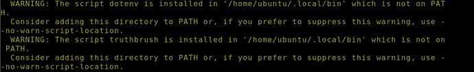

I installed a new python script,
and get the message that it (next to dotenv) is not in path.
Is that ok this way,
or how do I put it into path?

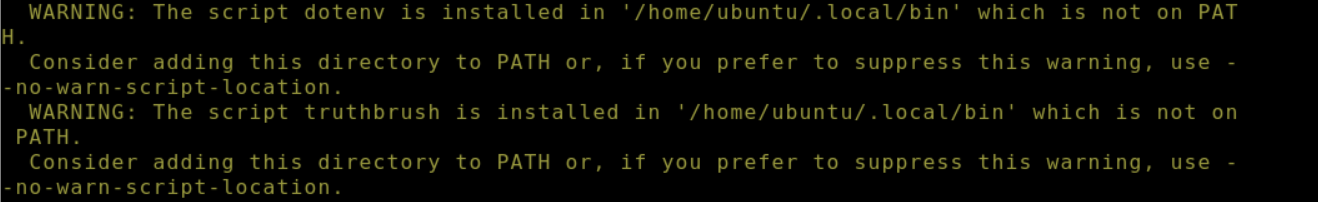

anyone?
Part of the issue is screenshots are hard to troubleshoot. try to copy and paste the text when asking for help.
type "echo $PATH " at the command line
you will see that the path in your error is not in the list.
the dot in the path looks suspect
also appears you are using a live install. I assume you have persistence setup if you want the script to stay upon a reboot
to answer your question
export PATH=/home/ubuntu/.local/bin:$PATH
however there was probably a mistake in the way you installed your script
