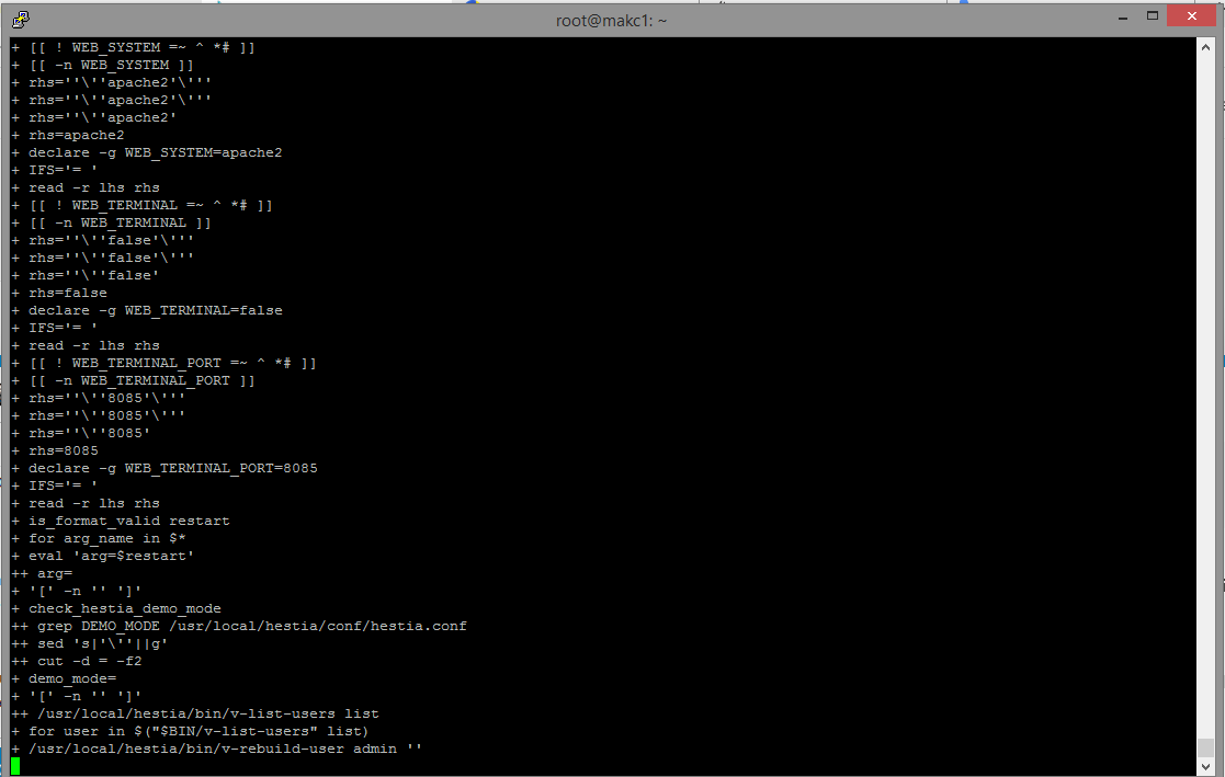

This inspired me and it seemed logical to me to run
bash -x /usr/local/hestia/bin/v-rebuild-users 2>&1 | tee /tmp/v-rebuild-users.debug
for everyone at once.
And here a surprise awaited me.
Execution stopped precisely at the rebuilding of the admin user, which had been successfully completed before.
And that’s all.
It still hangs.
It doesn’t make sense for me to restart
v-rebuild-user admin
, because it was just completed successfully.
And where it hangs now, I have a hard time understanding.
Please, friends, at least give me a hint in the direction.
