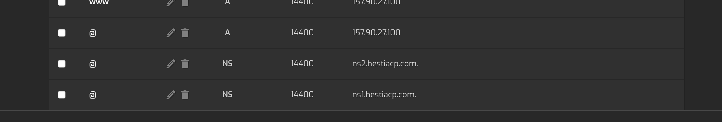

Default name servers should be ns1.domain.com / n2.domain.com It should contain your name servers and not the “general” / “google” name servers.
Currently you would be not able to use Hestia DNS…
