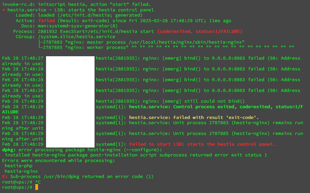

I could not get the command ‘v-stop-firewall’ to work; it just tells me it’s an unknown command. It’s probably correct, but it didn’t accept it. I also tried to run ‘apt update’ and encountered this problem. Could this be the reason?
Raphael
February 28, 2025, 6:03pm
16
apt install -f and check for further output. v-stop-firewall was correct and should load.

I managed to stop the firewall, but I cannot identify the problem in the logs. and trying to -f install it just trown out the same failed output.

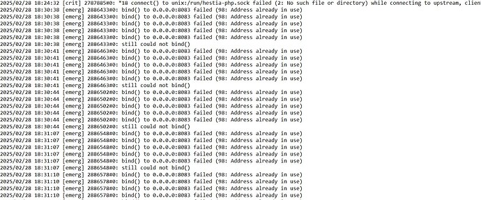

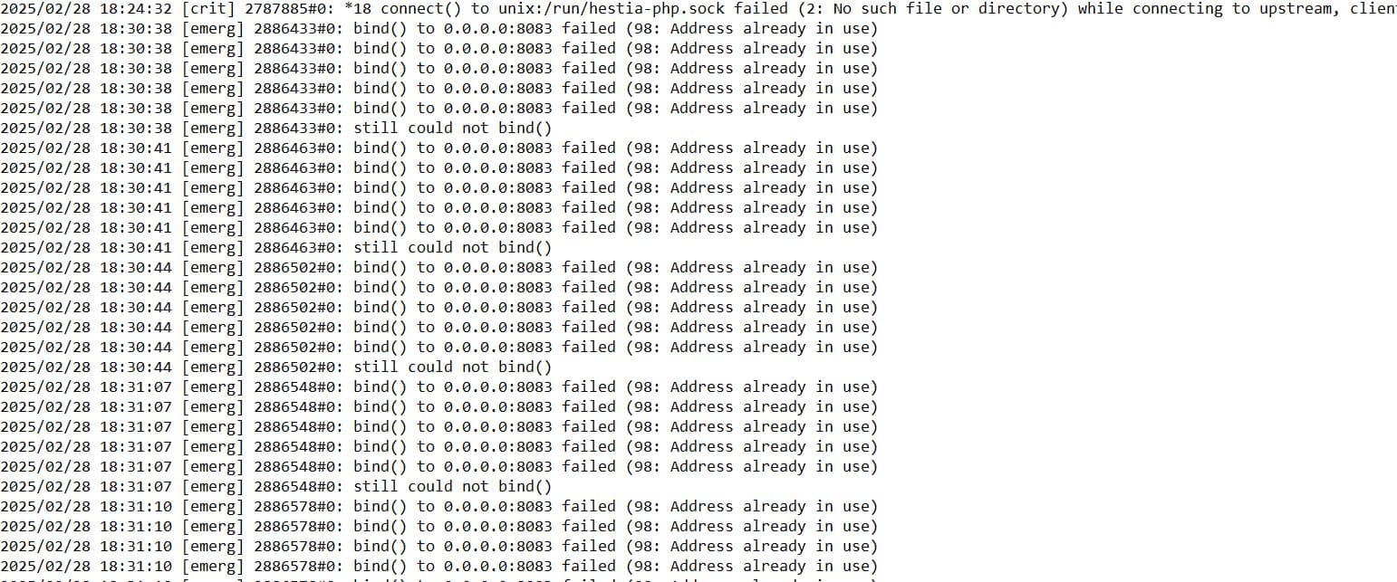

This is the only part of the log that I can identify as being the problem.
sahsanu
February 28, 2025, 6:48pm
19
One of previous hestia-nginx processes is still running so new hestia-nginx can’t finish the conf because it can’t use the port 8083.
killall hestia-nginx
and try again
