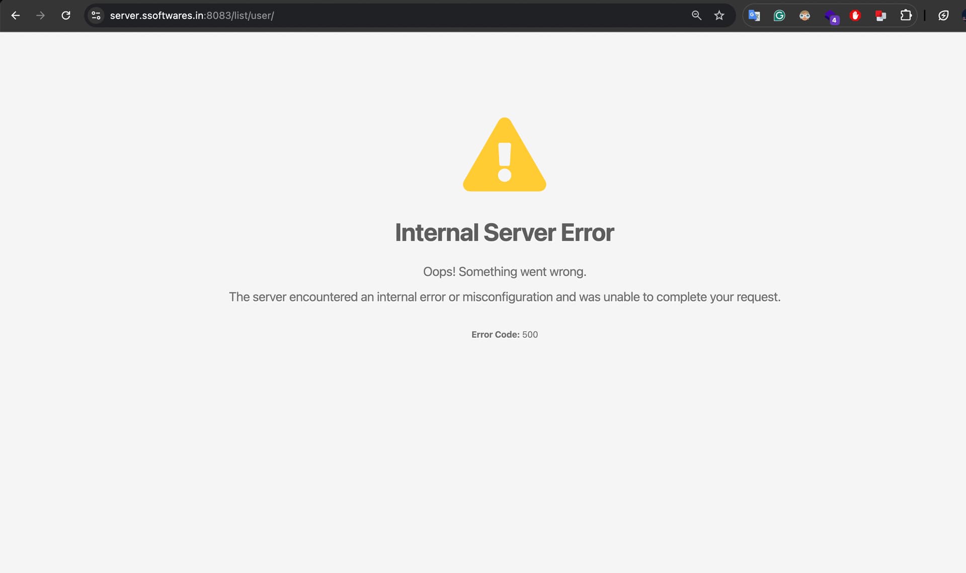

When I login into server using admin user, the shows “500 internal server error”.
Only the path “/list/user/” gives 500, rest other path like “/list/web/” works fine.

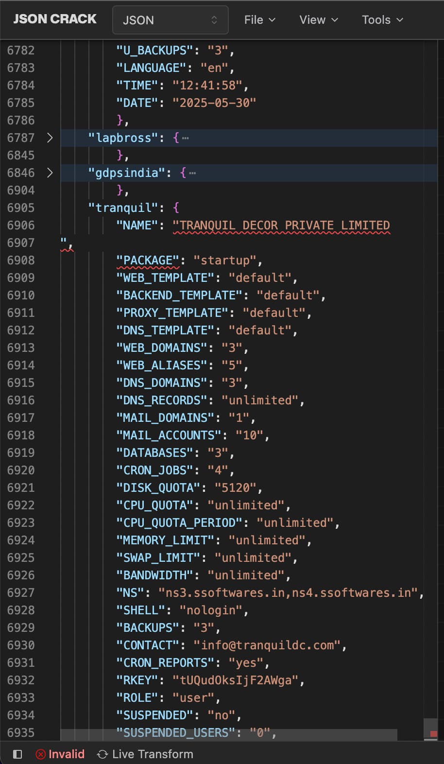

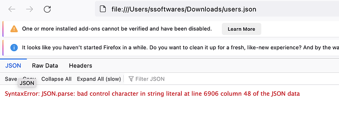

after tinkering a little bit, I get to know the index.php file is calling command /usr/local/hestia/bin/v-list-users json > users.json to get user’s list and then parsing it in JSON, the command returns json but it is invalid which I confirmed after using a JSON parser online, that is why the $data is null and ksort function return exception because it was expecting an array. FYI: I added ?? ; to prevent exception.
But the root issue is that the json returned through v-list-users command is invalid. How did it happen and how can I correct it down?
After tinkering further, Going to line 6906 I find the above code and highlited error line.
My question is how did it occur in first place with that extra line? Also, How can I fix it now?

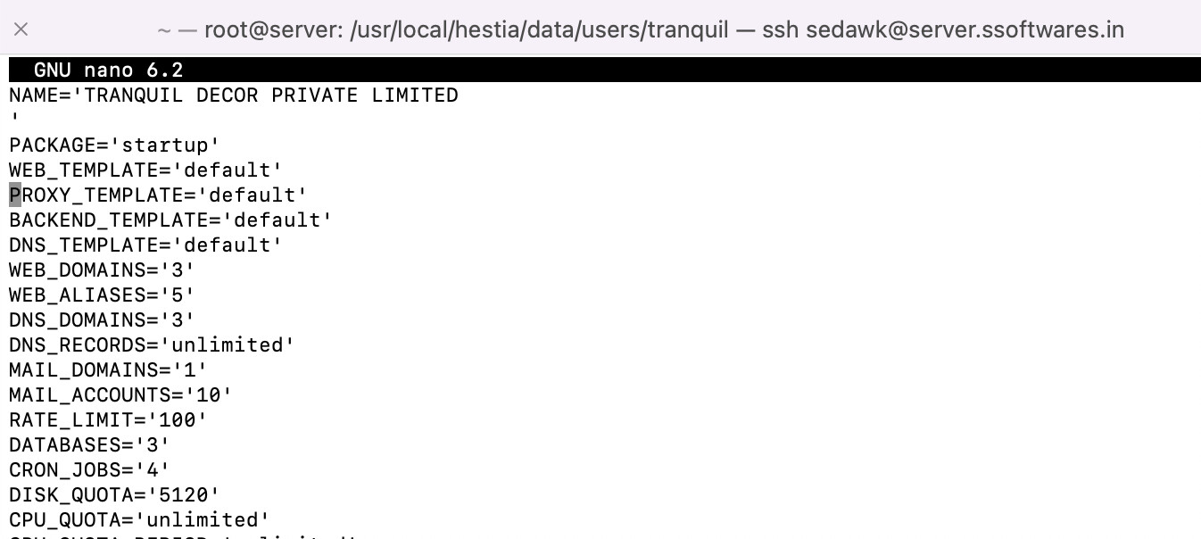

Reading the hestiacp v-list-users script, got to know that it reads user data from this file path /usr/local/hestia/data/users/$USER/user.conf , I went to the file and see the issue, there is a newline character in name,
Removing the newline character in user.conf file manually fixed the issue for me.
Root Cause: I think it happened because someone while adding user in my server pressed ‘Enter’ by mistake, or copied the name directly from somewhere which added newline character.
