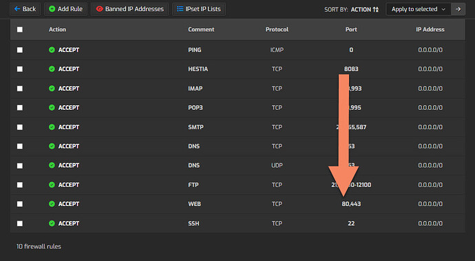

i have UFW disabled here is my firewall detail,
still not working ssl please help

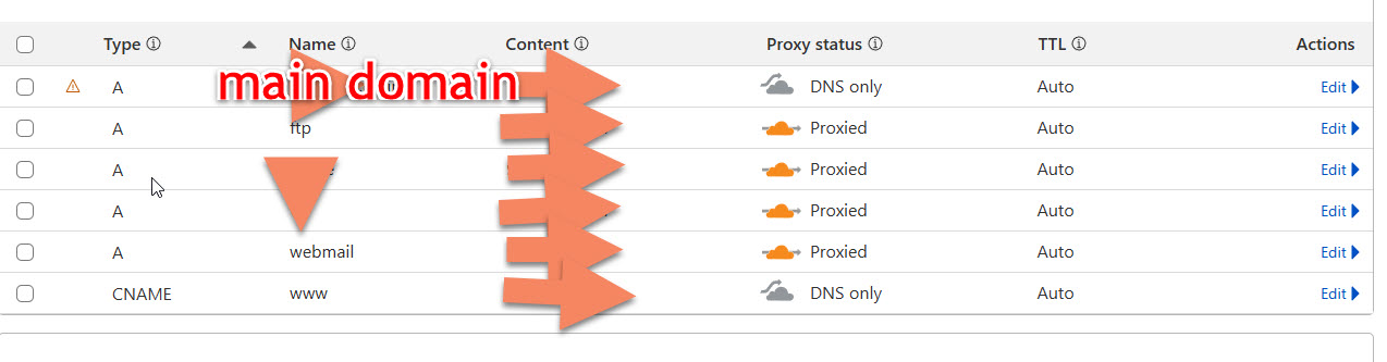

That domain still uses Cloudflare as CDN.
im checking an other domain this domain already active on ssl,
im change dns setting from cloudflare proxy to DNS only here is result.
