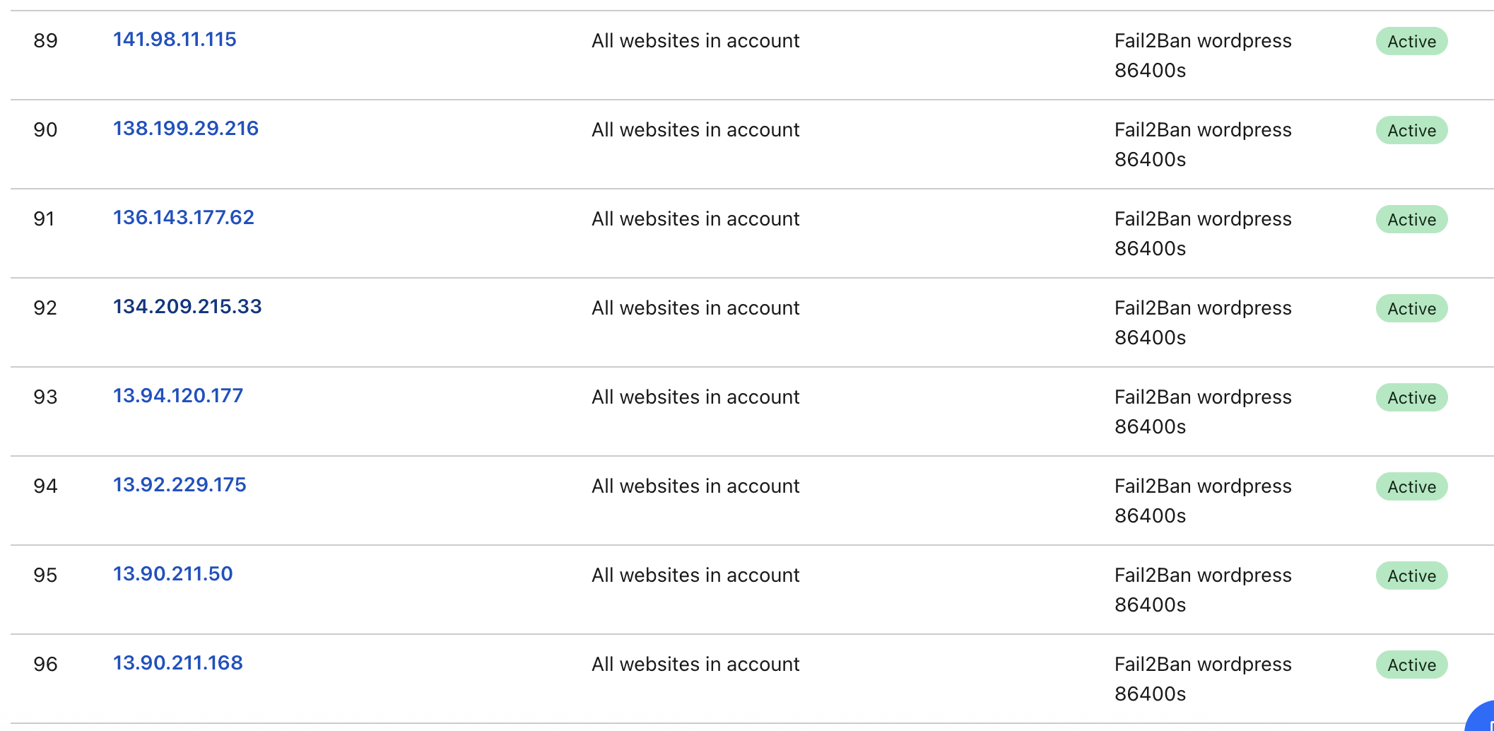

Weird – the truncated file loaded into Hestia without an error, but 196.251.88.45 (196.251.88.0/24) is still getting through. Adding it to fail2ban seems to get rid of the constant POST request.
