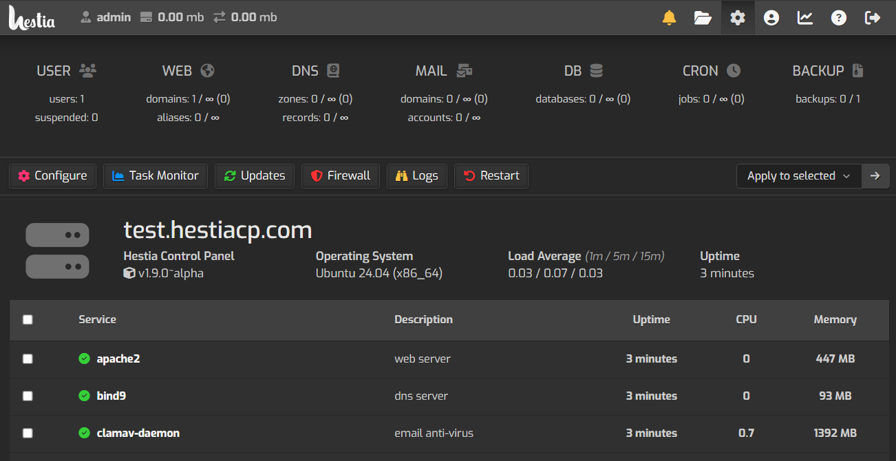

so far it doesnt look “that bad”:

I’ve just compiled the branch main and installed it on a Ubuntu 24.04. Seems to work fine. I’ve additionally installed a backup of another system. Web, Mail, DNS, DB, roundube, phpmyadmin work.
