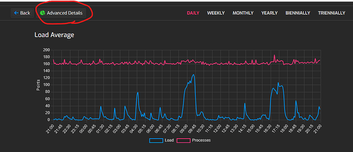

Issue at advanced details
I have a significant problem and don’t know how to solve it.

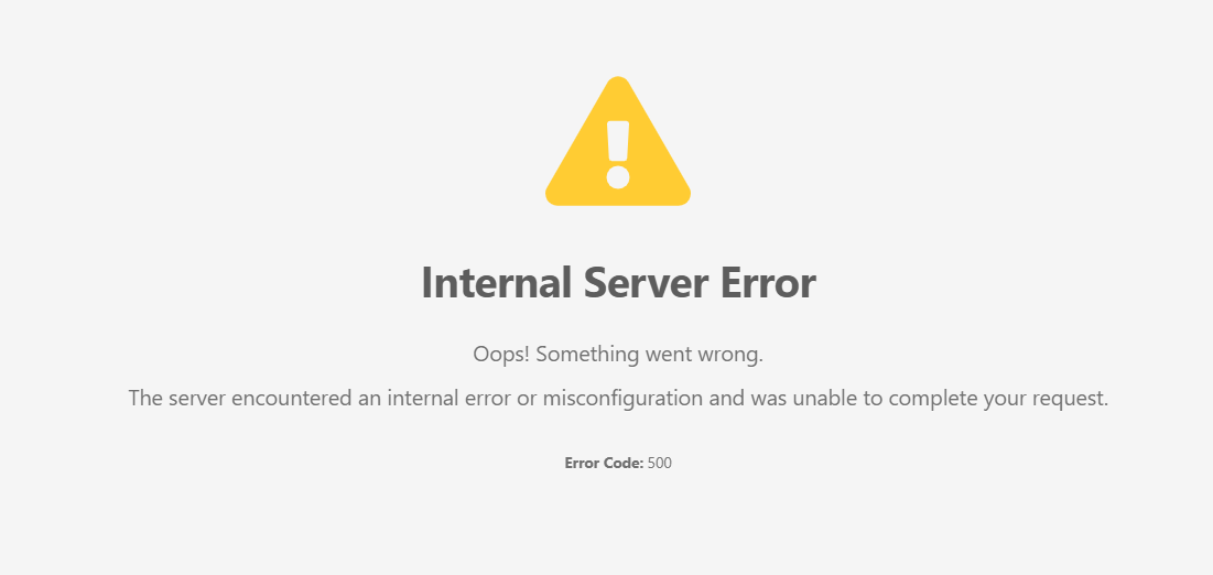

When accessing this setting, this message appears.
What is the solution, please?
To solve it, first you need to know what’s going on.
Check the error in /var/log/hestia/nginx-error.log
HYG
You are doing two wrong things, first, you are trying to execute a log file and second, you missed the first /
Reproduce the error again and execute this command:
tail -n30 /var/log/hestia/nginx-error.log
When pasting the output, please, use copy/paste, not a screenshot.
Debian GNU/Linux comes with ABSOLUTELY NO WARRANTY, to the extent
permitted by applicable law.
Last login: Wed Sep 16 18:11:31 2026 from 154.182.30.224
root@server:\~# tail -n30 /var/log/hestia/nginx-error.log
2026/09/16 17:53:35 \[error\] 790487#0: \*1 FastCGI sent in stderr: "PHP message: PHP Parse error:  syntax error, unexpected identifier "https", expecting ")" in /usr/local/hestia/web/templates/pages/list_server_info.php on line 19" while reading response header from upstream, client: 154.182.30.224, server: \_, request: "GET /list/server/?cpu HTTP/2.0", upstream: "fastcgi://unix:/run/hestia-php.sock:", host: "server.codak.net:8083", referrer: "https://server.codak.net:8083/list/rrd/"
2026/09/16 17:54:02 \[error\] 791312#0: \*5 FastCGI sent in stderr: "PHP message: PHP Parse error:  syntax error, unexpected identifier "https", expecting ")" in /usr/local/hestia/web/templates/pages/list_server_info.php on line 19" while reading response header from upstream, client: 154.182.30.224, server: \_, request: "GET /list/server/?cpu HTTP/2.0", upstream: "fastcgi://unix:/run/hestia-php.sock:", host: "server.codak.net:8083", referrer: "https://server.codak.net:8083/list/rrd/"
2026/09/16 17:59:20 \[error\] 791312#0: \*24 FastCGI sent in stderr: "PHP message: PHP Parse error:  syntax error, unexpected identifier "https", expecting ")" in /usr/local/hestia/web/templates/pages/list_server_info.php on line 19" while reading response header from upstream, client: 154.182.30.224, server: \_, request: "GET /list/server/?cpu HTTP/2.0", upstream: "fastcgi://unix:/run/hestia-php.sock:", host: "server.codak.net:8083", referrer: "https://server.codak.net:8083/list/rrd/"
2026/09/16 18:01:00 \[error\] 791312#0: \*36 FastCGI sent in stderr: "PHP message: PHP Parse error:  syntax error, unexpected identifier "https", expecting ")" in /usr/local/hestia/web/templates/pages/list_server_info.php on line 19" while reading response header from upstream, client: 154.182.30.224, server: \_, request: "GET /list/server/?cpu HTTP/2.0", upstream: "fastcgi://unix:/run/hestia-php.sock:", host: "server.codak.net:8083", referrer: "https://server.codak.net:8083/list/rrd/"
