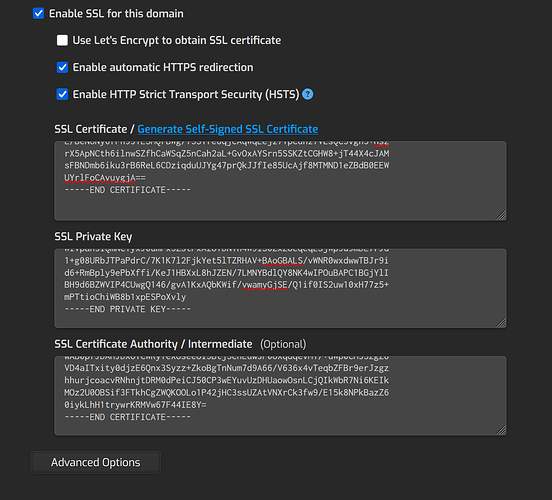

Keep getting SSL not enabled
Keep getting SSL not enabled. What is the solution for cloudflare certificates?
Check if IPV6 is setup. If yes, remove that entry from there.
Also, check if all DNS entries are available. Give 45-60 minutes time after changing for it to propagate and then try.
Have you removed it once, then added it again?
no IPV6
It’s on Letsencrypt cert. I’m trying to change to cloudflare cert to forward visitors’ headers to nginx/apache
Would it work if the website is first deleted from Hestia, next added, and then install Cloudflare certificates?
Disable ssl, save, enable ssl and add then the cloudflare cert.
Yes. This works. Thank you
