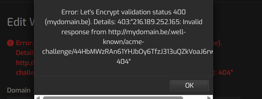

i’ve added a second ip address (using the ip im using for NS2), ive added a new domain to resolve its dns on the this second ip address (propagated it fully after 48 hours). http and https resolve correctly with a success page.
But when adding letsencrypt it gives me an error, tried many manual hacks (and reverted them) but not getting it to work. what am i missing?;
v-add-letsencrypt-domain main mydomainname.be Error: Let’s Encrypt validation status 400 (mydomainname.be). Details: 403:“201.189.252.165: Invalid response from http://mydomainname.be/.well-known/acme-challenge/q87fpquI3bu6KMWIZv9EdC-AV_TH8anrADZbtN8joMQ: 404”
