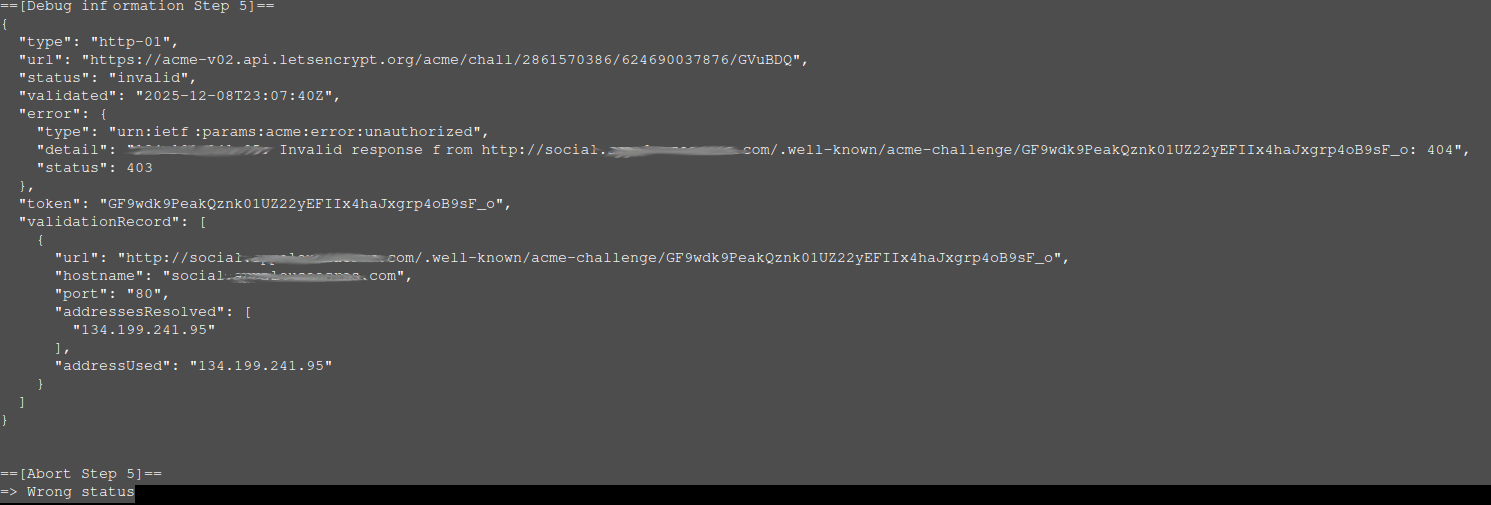

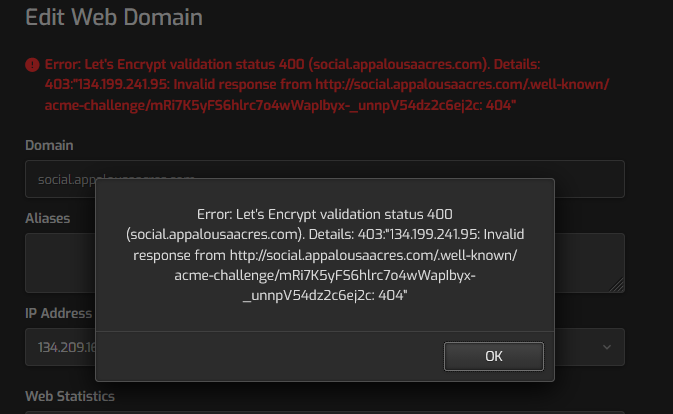

I’ve spent most of the day today trying to get a Let’s Encrypt certificate working. I see lots of folks with similar issues and have tried different suggestions, all to no avail. The host server is a VPS running Ubuntu 22.04. DNS is provided through name.com, which is where the domain is registered. There are no IPv6 DNS records in use. I’ve tried creating new templates (copy of default.tpl and default.stpl) with additional location information specifically for the .well-known/acme-challenge folder and applying those to the domain I’m working with. I’ve tried getting the certificate with and without automatic HTTPS redirection, but nothing has worked. Here is the output from the latest attempts to get a certificate issued.
Any suggestions would be greatly appreciated.

Are you aware that the IP used in the nginx.conf is not the same as the IP used by your domain?
Nginx conf:  134.209.166.60
Your domain: 134.199.241.95
You must fix that.
I did not realize that. I’m using Digital Ocean for my VPS and their setup has both of those IPs associated with my account. I’m going to change my DNS to point to 134.209.166.60 and will let you know what the outcome is.
That got it. You are good. I really appreciate your help. A donation will be headed your way!
