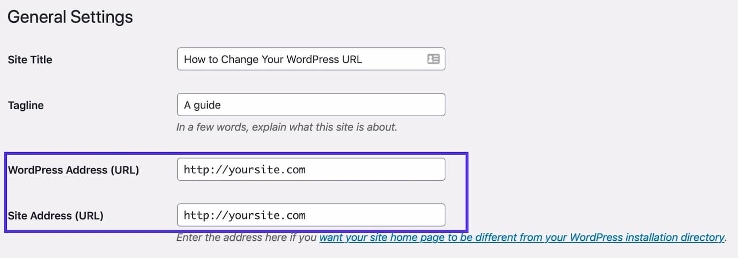

I would like to start by saying that i had never used previously hestia, so im not really familiar with how everything works. Some weeks ago i wanted to create an online website, purchased a domain, rented a Linode VPS and then, install hestia on it (from which i downloaded wordpress). My original domain (lets call it mydomain.online) was created with an admin account. I got a notification saying that i shouldnt be creating websites with my admin account, so i went on, created a new one and went along. I forgot to delete the original domain, so on my seconds account, i created the website sr1.mydomain.online, on which i downloaded wordpress and on which i had set up everything. However, i knew that it wasnt really professional to use subdomains on these, so i saw this option on wordpress, and said oh cool, changed it to mydomain.online without giving a second thought.

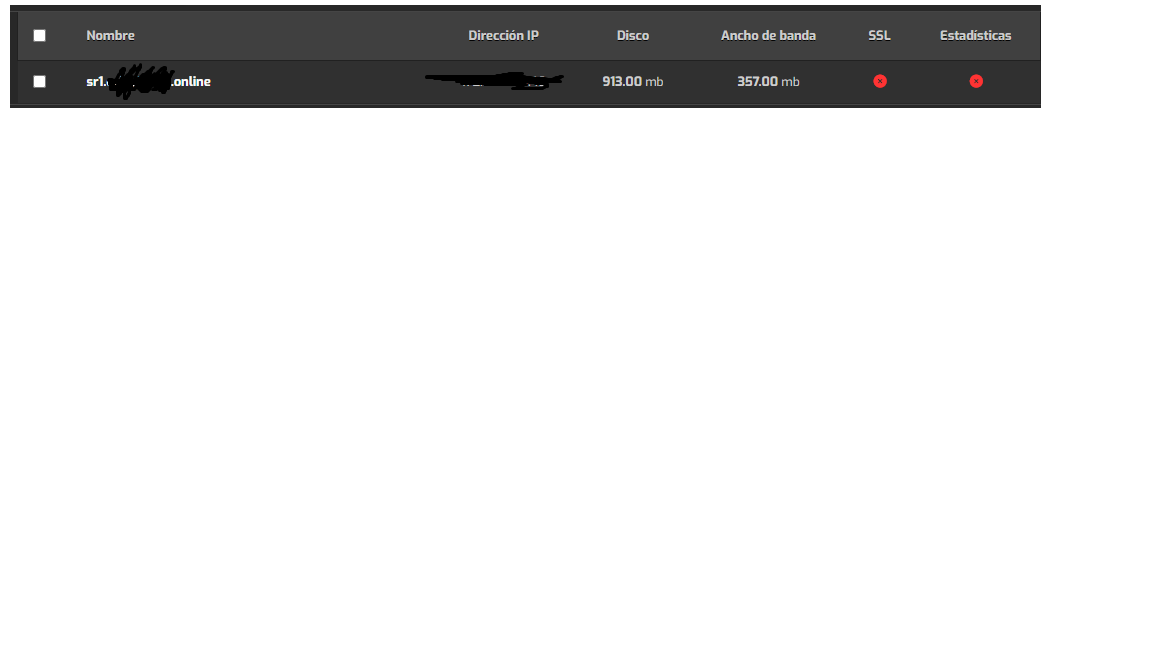

I can see on hestia, i can see that my website is worth of 900mb, but i cant access it in any way.
I also went on to the wpconfig.php file on hestia, and added the following code to try and regain access to my website the previous way (since i no longer really care about the subdomain thing)
define( ‘WP_HOME’, ‘http://yoursiteurl.com’ );
define( ‘WP_SITEURL’, ‘http://yoursiteurl.com’ );
But this didnt work neither. Is anything i can do? I just want to regain access to my site. I spent so much time setting it up.

i used those commands and the sr1 seemed to be there already. I executed the commands incase anything was wrong, but i got the same result. Just added an image of my site. I dont even get an error, it simply says that the site doesnt exist. I have tried on many search engines and got the same result. Wouldnt it be possible to export the files or something? And use them on another subdomain. As far as i can see on Hestia, the site is supposed to be working
