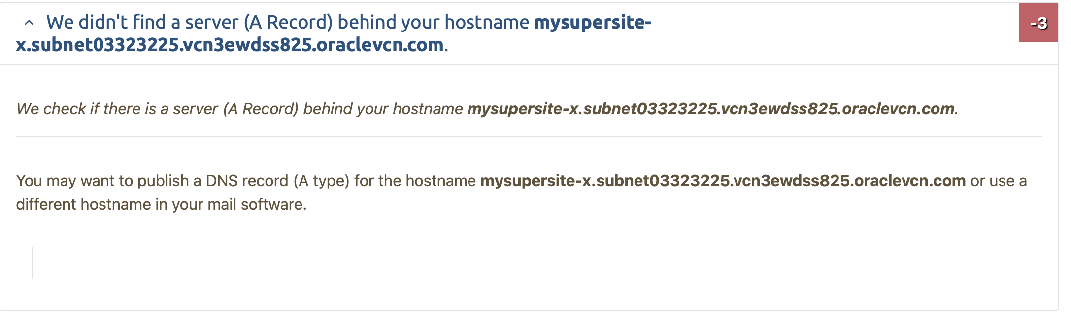

However, when trying to send an email, recipients or mail testers like mail-tester[.]com are returning this:
So it looks like the emails are being sent with the wrong hostname

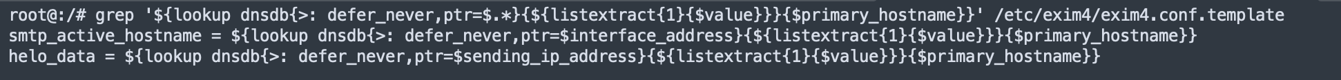

Check what are the directives using lookup dnsdb to get the primary_hostname:
grep '${lookup dnsdb{>: defer_never,ptr=$.*}{${listextract{1}{$value}}}{$primary_hostname}}' /etc/exim4/exim4.conf.template
You should see 3 of them, one smtp_active_hostname and two helo_data. Search them in exim conf file /etc/exim4/exim4.conf.template and just replace their values with your hostname.
smtp_active_hostname = whatever.yourdomain.tld
helo_data = whatever.yourdomain.tld
Save the conf file and restart exim4.
The grep command returns this:
So I just need to replace the smtp_active_hostname and helo_data with the PTR domain?
Yes. Just that, but make a backup of the conf file before the change.
That worked, thank you! I’m not sure why I had to do this since it was working well
