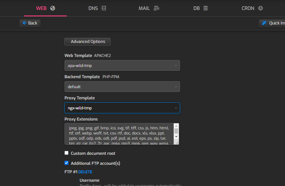

What I hadn’t done is copied the non-ssl templates to apa-wild-tmp.tpl
I have done that now, and can see options in both.( see images )
The top portion looks like this
with the wildcard - is this correct ?
