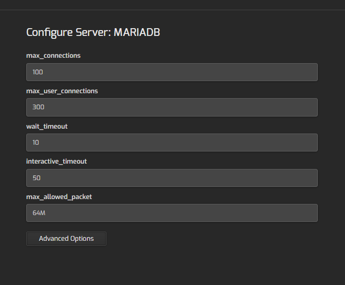

But how much memory available?
Saw couple of warnings about some crashed tables.
But I just increased the max_allowed_packet
from 16M
to 64M
. I don’t really know what that is.
I have about 4GB memory free. Total VPS memory is 8GB

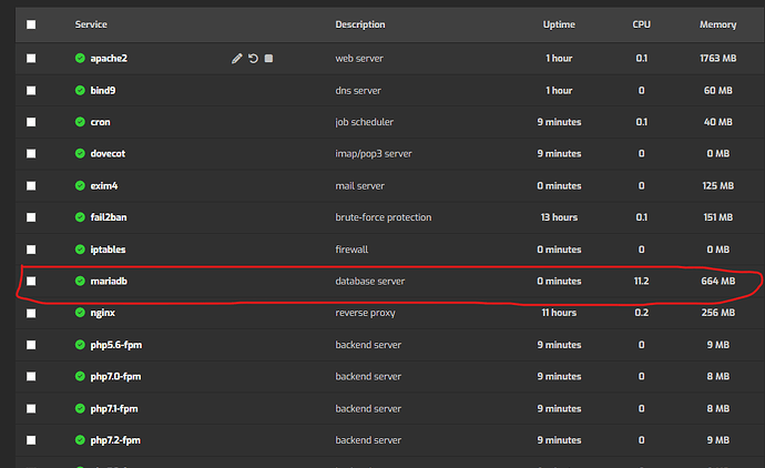

Right now it’s active. I restarted it when it failed. See the systemctl status:
It has stopped working 3 times today.
