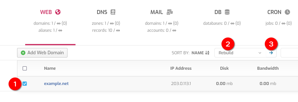

Once you modify a template, you must rebuild the web domain to apply the changes.
From GUI:
From command line:
v-rebuild-web-domain USER DOMAIN [RESTART]
Example using test as user, example.net as domain and yes to restart the web services.
v-rebuild-web-domain test example.net yes
