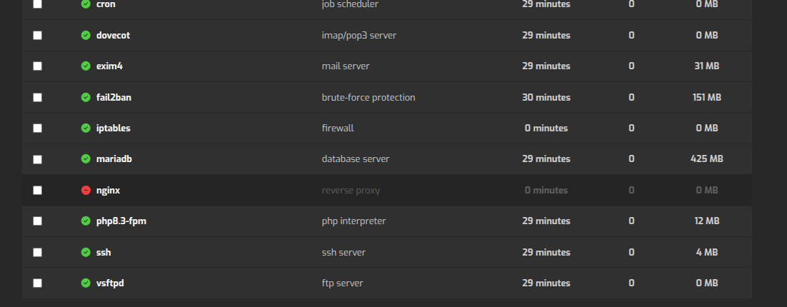

Nginx not starting
Please help me to solve nginx not starting error:

yesterday, i just press start service and it worked. now this solution is not working:

In the meantime I executed the last command you have mentioned: nginx -g “daemon off;” and the services have started after few good seconds (probably 1-2 minutes), then I stop it with ctr+c, the services stopped, after that I start normally the nginx services and everything is back to normal. I have no idea why this happened.

When was not working starting or querying status of nginx services took about 1 minutes and it was very slow. Also I rebooted the vps few times, without any luck.
