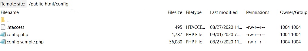

Permission should always be user:user (inside the public_html directory).
Hello
Thank you for your support.
I have everything inside the public_html directory set to user:user permission.
I have also “.htaccess” set to “644” and “/data” set to “770” but I am still getting this error on the log.

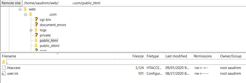

Why you dont just use the tar source code and place it inside public_html? According to https://docs.nextcloud.com/server/latest/admin_manual/installation/source_installation.html this should be the way to go and should work out of the box.
That’s wrong and the reason why apache complains about the non readable htaccess. It should be 755 as with all other directories.
Ps: everything you did afterwards probably messed it up even more.
Nextcloud works extracted from the regular archive oob. just make sure owner and group are correct nothing else. I run it myself, so I know for sure it works without custom templates :wink:
