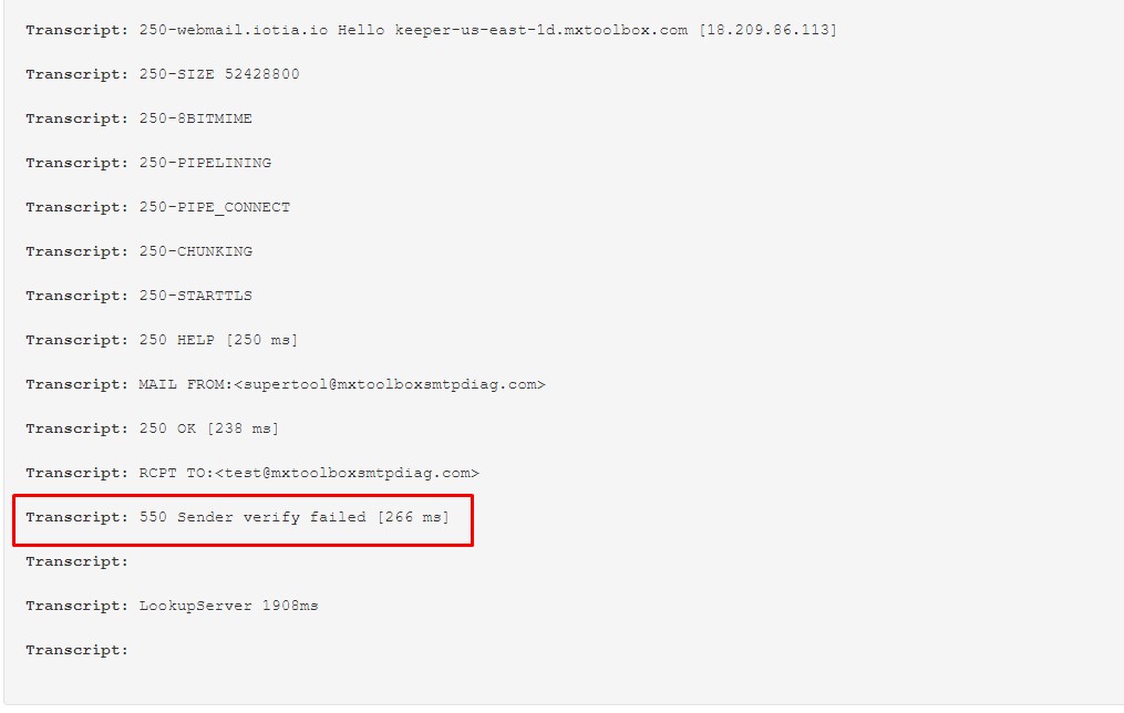

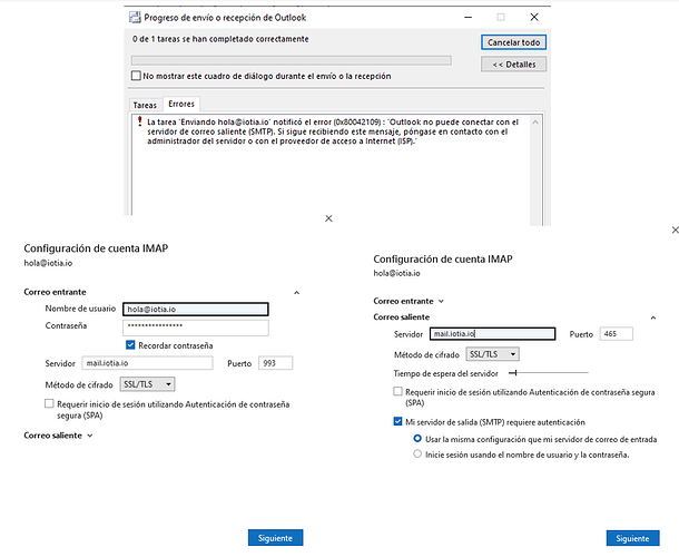

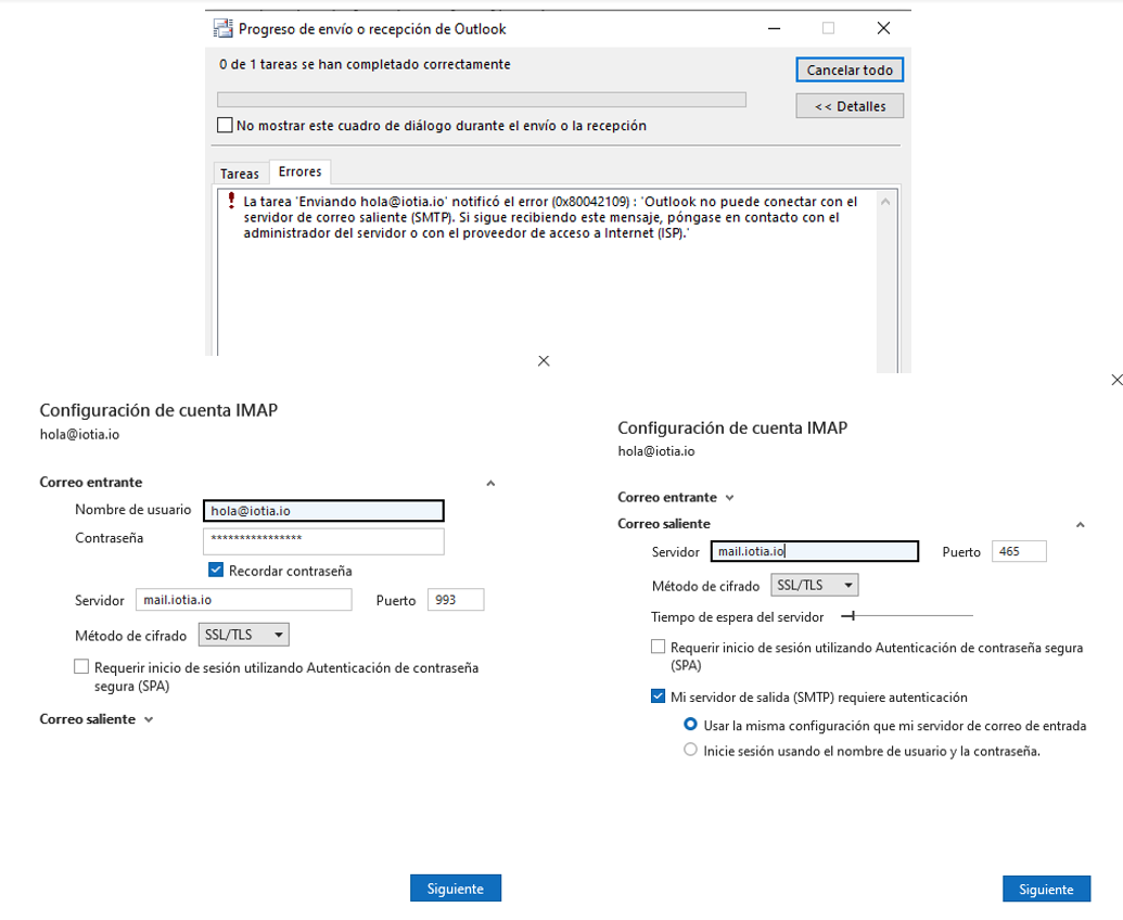

I told him that the domain is www.iotia.io, I told him that we have used the same parameters, even now I wanted to send an email but it gave me an error. I attach images.
I tested it several times and sometimes I can connect to port 465 and others I can’t so maybe a firewall is doing something weird or doesn’t like my country With port 587 and starttls I’ve no issues to connect to your server.
That isn’t an error, that means that [email protected] is trying to use your smtp server to relay an email to external account [email protected] and your server said no no no and that means you are not an open relay and that is good, so all is working as expected.

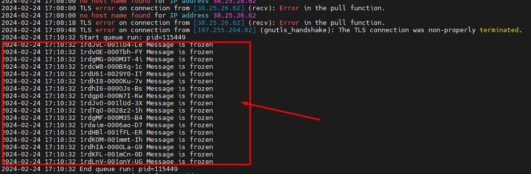

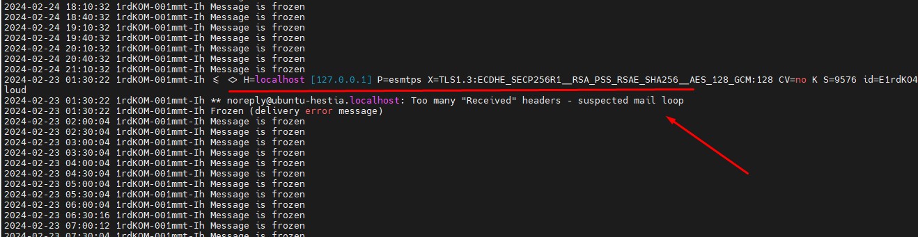

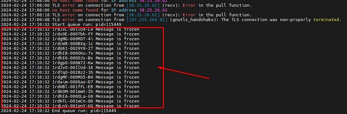

External emails from [email protected] do not reach [email protected], I see that you put them on hold-frozen.
I obtained these logs by entering /var/log/exim4/mainlog

What do you mean with external? Because as far as I can see, smelpro.com and iotia.io share the same server (217.196.62.140) so if smelpro is really an external domain, you should delete it from the Hestia server. Anyway, I’m just guessing so to know why the messages are hold, the message id and serch the exim logs:
Example (replace 1rdxxx-123456-YY by one of the message ids)
Sorry for my mistake, smelpro.com was on bluehost 1 month ago, then it was migrated to the hostinger VPS along with iotia.io and its emails are managed by Hestia, but for some reason it happens that they are not arriving from [email protected] to [email protected]
