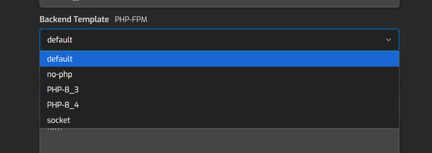

Hi, I would like to know if I am switching the PHP from default to PHP-8_4, what template I need to update? anything related to my custom templates from /apache2/php-fpm and /nginx?
Or I just simply switch from here?

Hi @jasonwch
If you are using default as backend template in your web domain and you want to switch to PHP 8.4, you just need to select it in the drop-down list.
If for example, you are using the backend template socket, it will use the default php version (by default it’s 8.3) so in this case, if you only want to use socket and PHP 8.4 for one of your web domains, you must create another template adding to the name the right PHP version.
cd /usr/local/hestia/data/templates/web/php-fpm/
cp socket.tpl socket-PHP-8_4.tpl
And now, you can select socket-PHP-8_4 from Hestia.

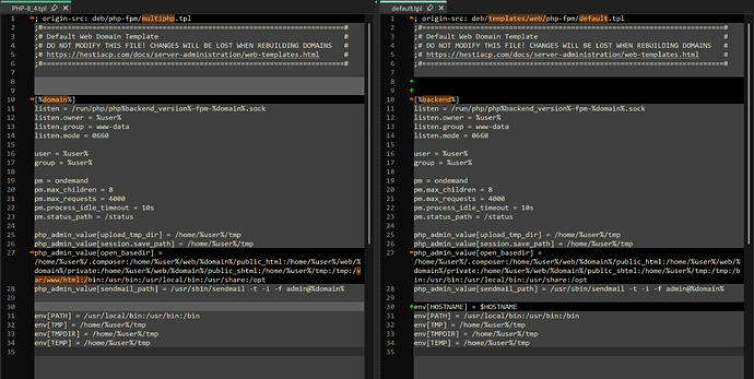

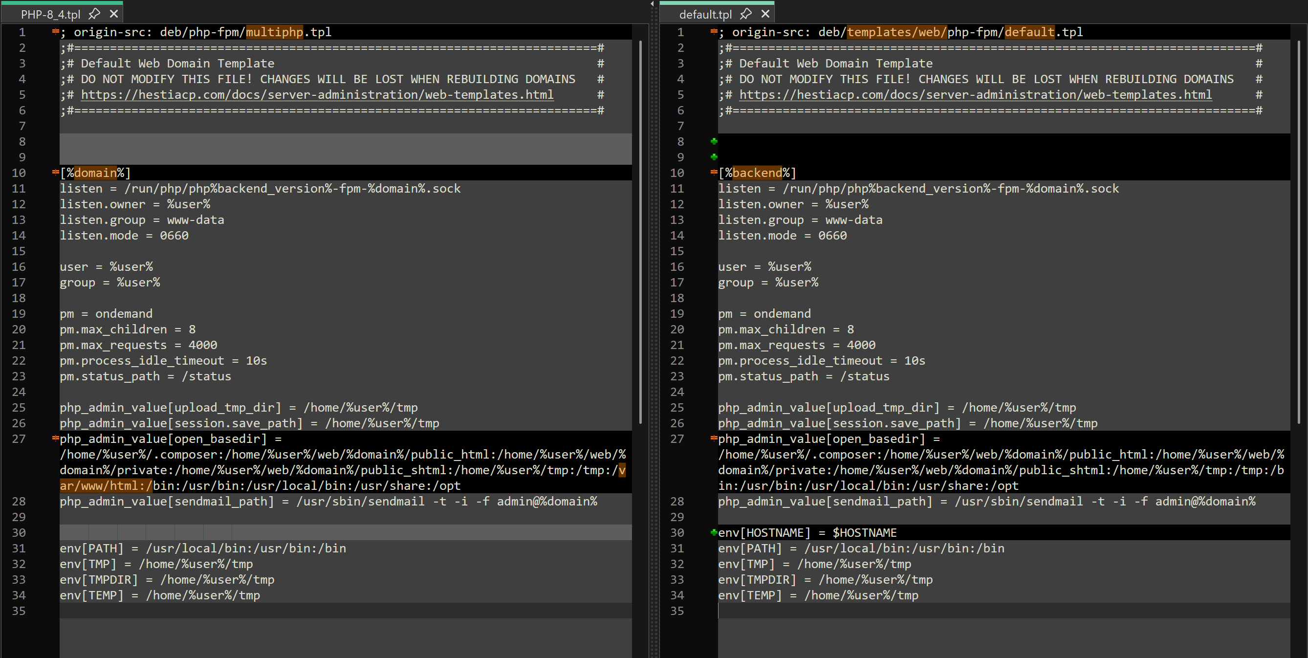

So the web/php-fpm templates will trigger to use respective /etc/php/8.X/fpm/php.ini?
Btw, there are some differences when comparing default and php-8.4 tpl. Is it something intended? and would you mind to explain a bit more on this? Thanks so much

I would need to review the code to understand the reason for the differences, but if you want to use one, use the PHP-X_Y.tpl.
