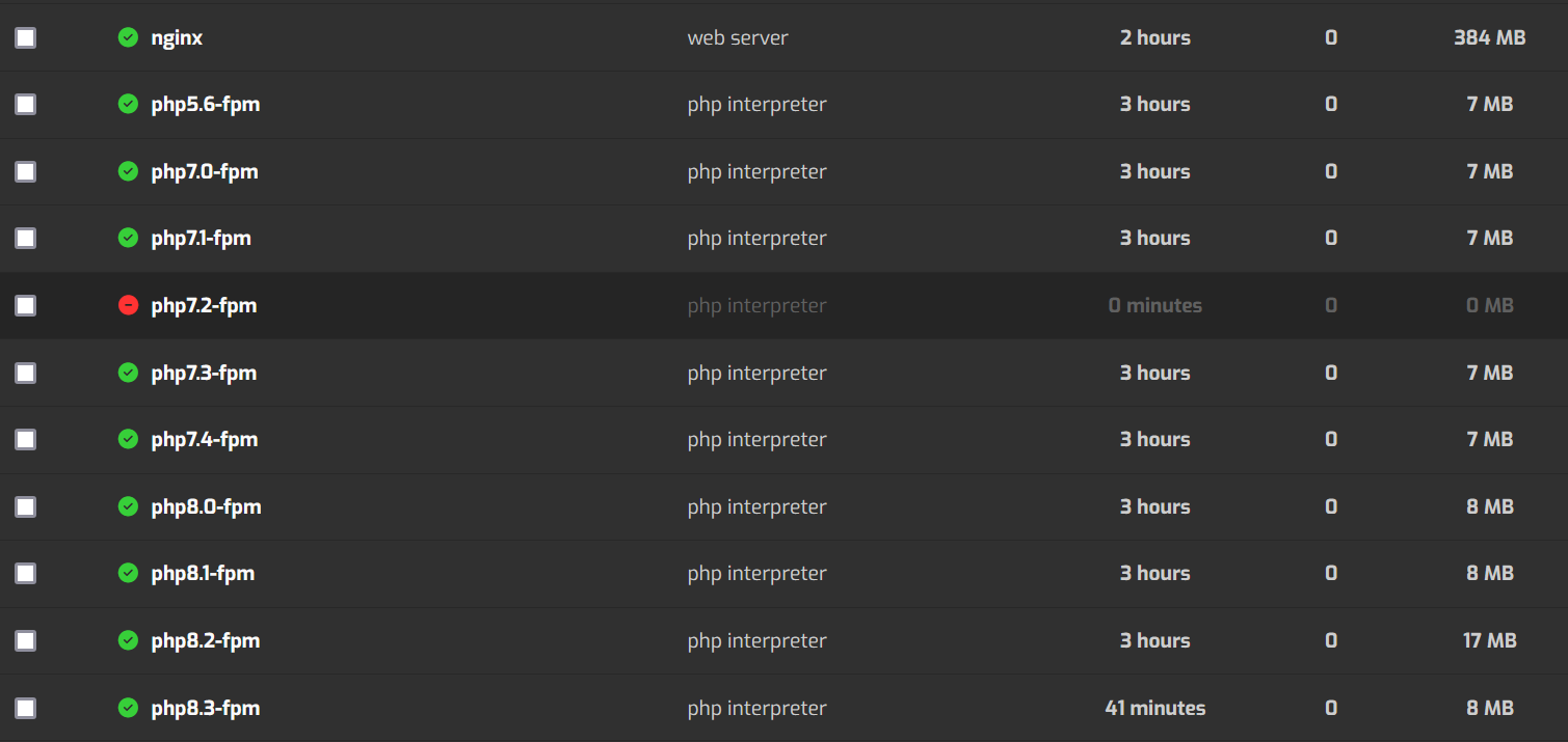

Php7.2-fpm does not start, others *-fpm work
For some reason, php7.2-fpm doesn’t work, while the others do.
I tried to restart it - no result.
The panel version is 1.9.0 - alpha
