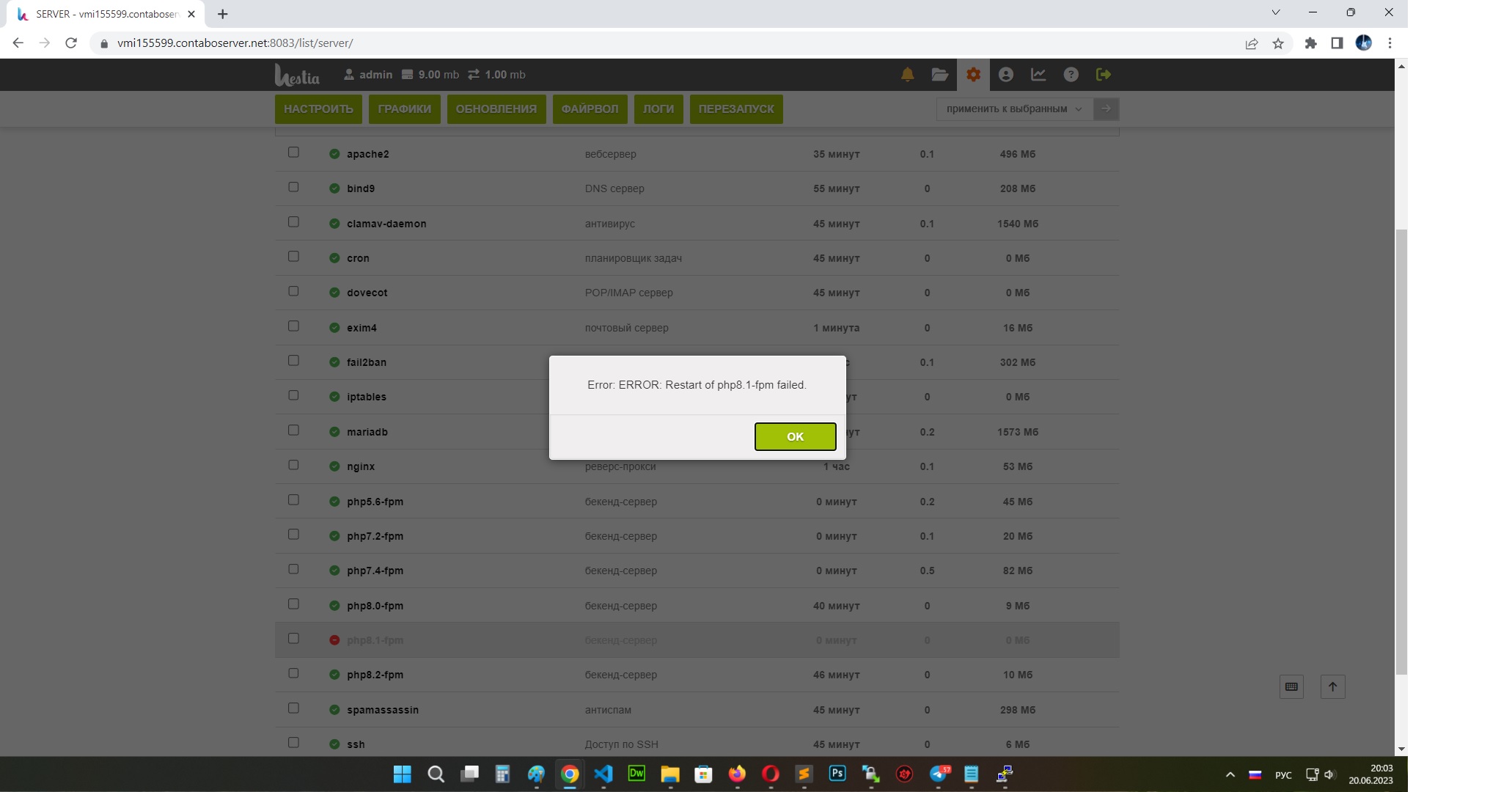

Php8.1-fpm does not work
I stopped working php8.1-fpm
I restart it, I get the result: Error: ERROR: Restart of php8.1-fpm failed.
I can enter template edit mode and when saving it does not give an error.

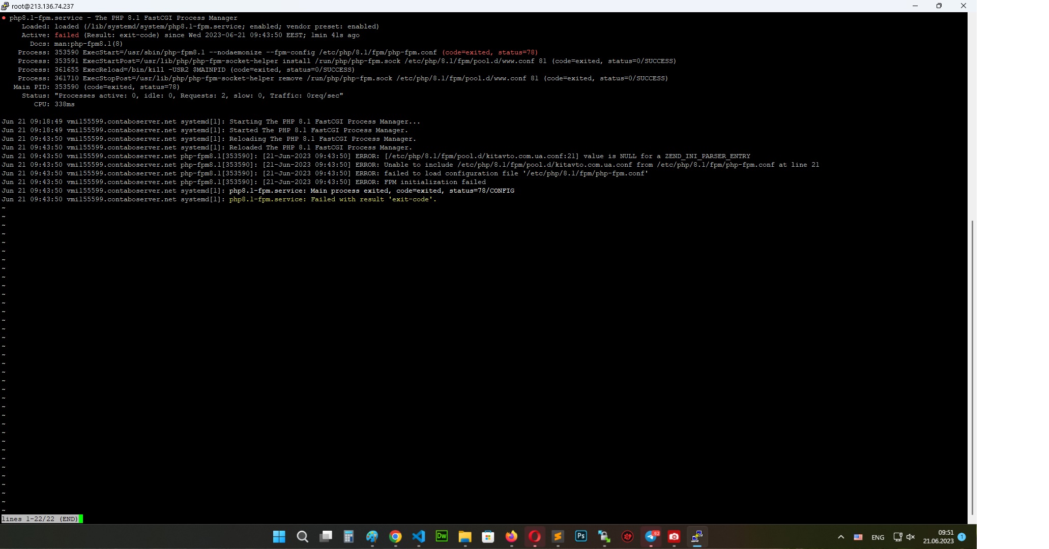

systemctl status php8.1-fpm
systemctl restart php8.1-fpm
The result of this command is the following:
After getting the error I removed /etc/php/8.1/fpm/pool.d/file.conf
After that I got the following error:
I ended up deleting all the config files that gave value is null.
