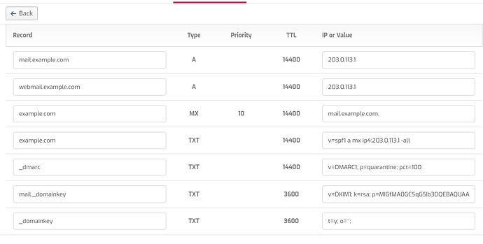

You should add the right SPF and DMARC records to your domain (both are TXT records) and also activate DKIM in Hestia for your mail domain and add the right TXT record.
To view the dns records you must add in Cloudflare, login in Hestia with your user → Mail → hover the mouse over your mail domain and you will see these icons, click on the 4th and you will see the records.

i’ve added records and enabled DKIM but still have mails in spam folder.

And DMARC and SPF? If you share your domain (you can send me a private message if you don’t want to post it publicly) I could check your dns records.

seems i fixed it by adding all the records i have.
it were added only spf and dmarc. mails are not in spam anymore.
