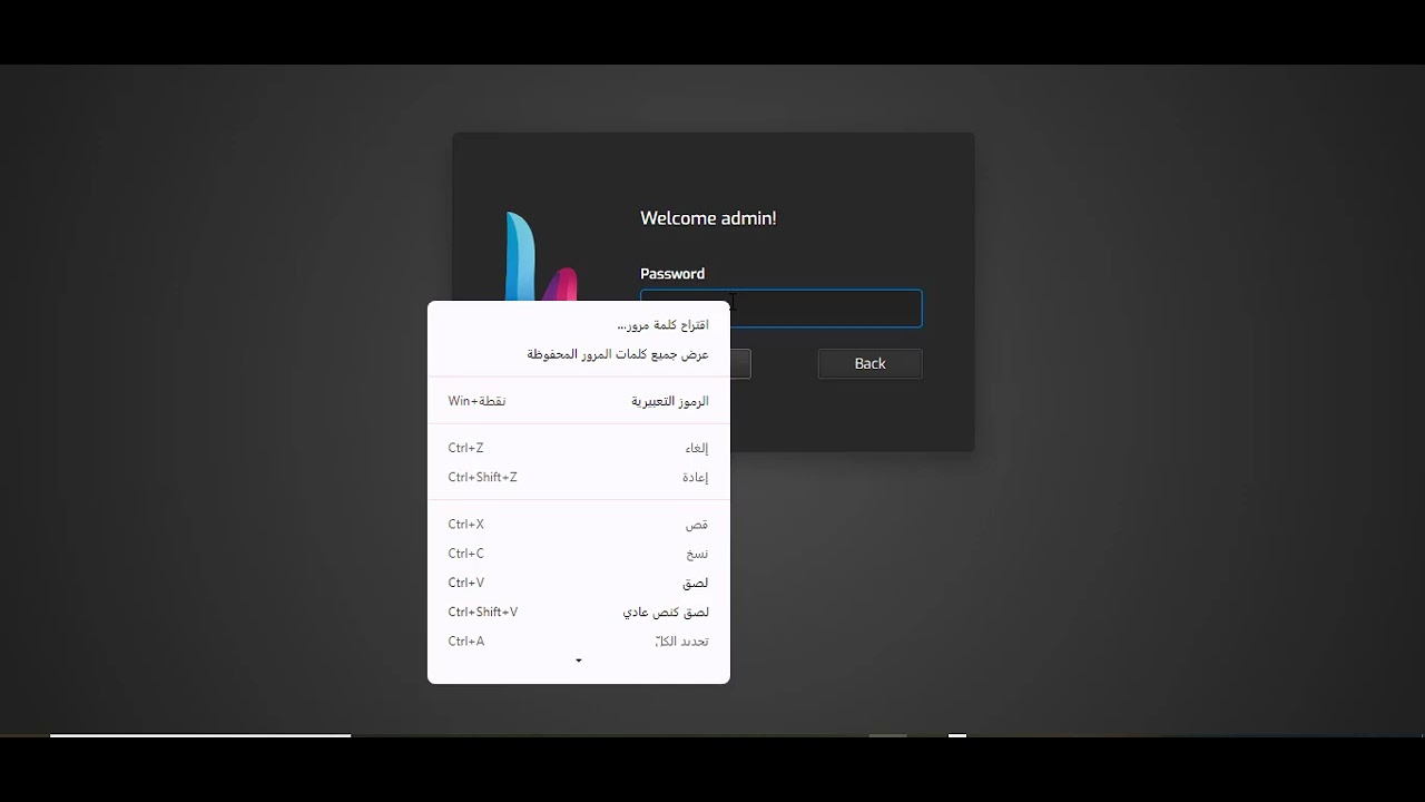

Now I can no longer log in to the hestiacp control panel. It has gotten worse for me from everywhere. Please help me :sob::sob:

Please tell me how can I login to hestiacp control panel. At least I will make a manual backup of the files. Then I will make a new hestiacp control panel. I don’t have enough experience.
Can you help me give me any commands that I can use to access the hestiacp control panel?
