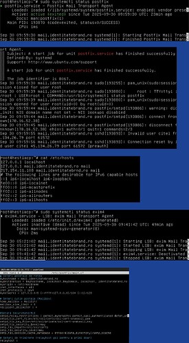

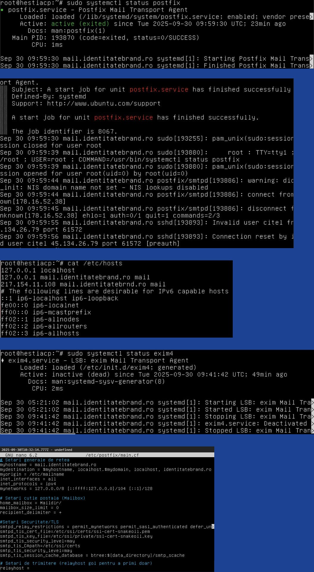

I am facing a critical issue where my Postfix MTA is failing to start and remains consistently in an Active: active (exited) state, blocking all incoming mail for the domain https://identitatebrand.ro. This issue started after an attempt to set up SendGrid, which I have since completely reverted and cleaned up.
The problem is confirmed to be at the Systemd level, not the application configuration.
Evidence of the Problem (Please see attached screenshots):
  1. Persistent Postfix Failure:
    • Status: Active: active (exited) (e.g., sudo systemctl status postfix)
    • Log Confirmation: The systemd journal shows code=exited, status=0/SUCCESS. This proves the service start script is exiting successfully, but Postfix is immediately dying/shutting down.
  2. System-Wide Failure:
    • The other MTA, Exim4, is also in a failed state (exited), confirming this is a system-wide issue affecting all mail services.
Troubleshooting Steps Already Taken (Unsuccessful):
  • Networking: Hostname is correctly set to mail.identitatebrand.ro and aligned in /etc/hosts.
  • Configuration: Cleaned and re-ordered /etc/postfix/main.cf to ensure proper syntax and removed all relay settings.
  • Hestia Tools: Ran both v-rebuild-mail-domains identitatebrand.ro and v-rebuild-user.
  • Reinstallation: Completely removed and reinstalled the Postfix package.
Request:
Since all configuration troubleshooting has failed, I suspect a corrupt Hestia-specific Systemd unit file or a deep-level permission conflict impacting the mail services. I need assistance diagnosing why the Postfix process exits immediately after systemd registers a successful start.
Thank you for your help!
