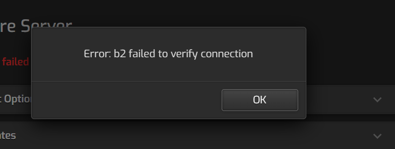

Problem settting up remote backup with Backblaze
I have entered the bucket name, key ID and application Key. I have also generated the appplication key multiple times but I still get this error message when I click save. What could be the problem please?

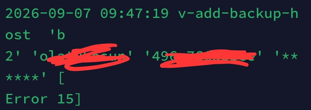

Checking the error log. Here is what I found.

I believe Rclone is different. I am setting up BackBlaze which does not required Rclone.
Actually, you are correct, I am mistaken, hestiacp seems to include a Backblaze now. So perhaps you have an issue with the endpoint format?
The docs says it automatically resolves the endpoint, however, it doesn’t seem to be working.
I would try it with rclone if I needed it. I don’t see any reason not to stick with restic for now.
Ok, from the command line it seems to work:
Backblaze B2 (native)
v-add-backup-host ‘b2’ ‘my-bucket’ ‘keyID123’ ‘applicationKey456’
yeah, that worked:

It is a bug
This should fix it…
B2 was supported way before Rclone was. But Rclone also support B2 as backup host…
