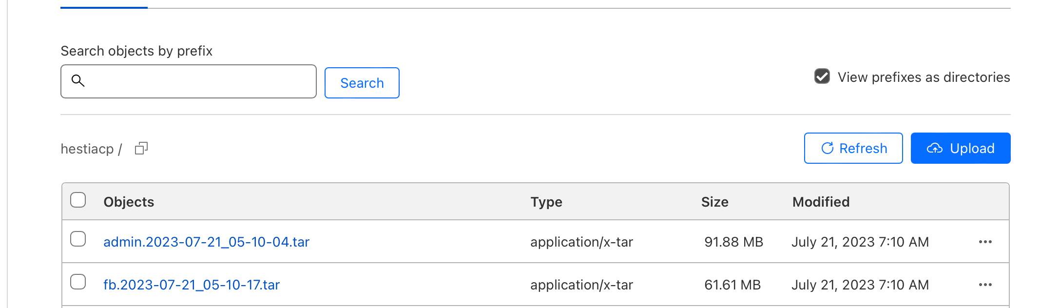

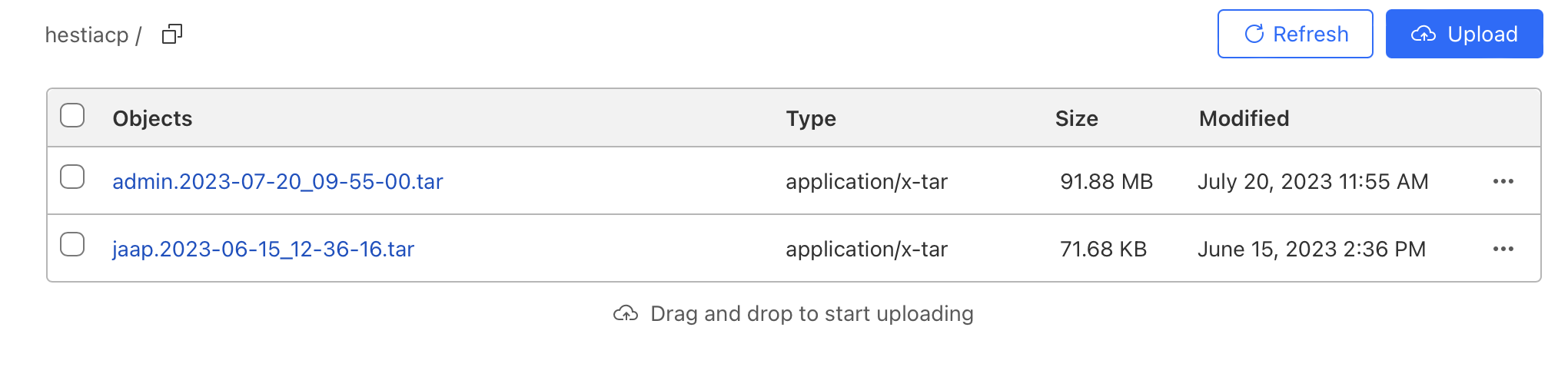

And I see:

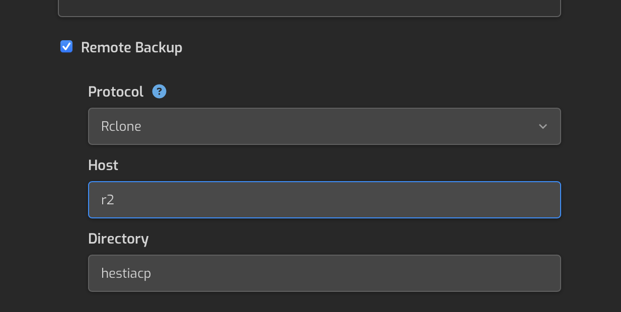

How is the config in hestiacp?

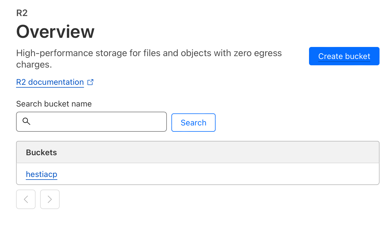

The root of Cloudflare R2 should look like:

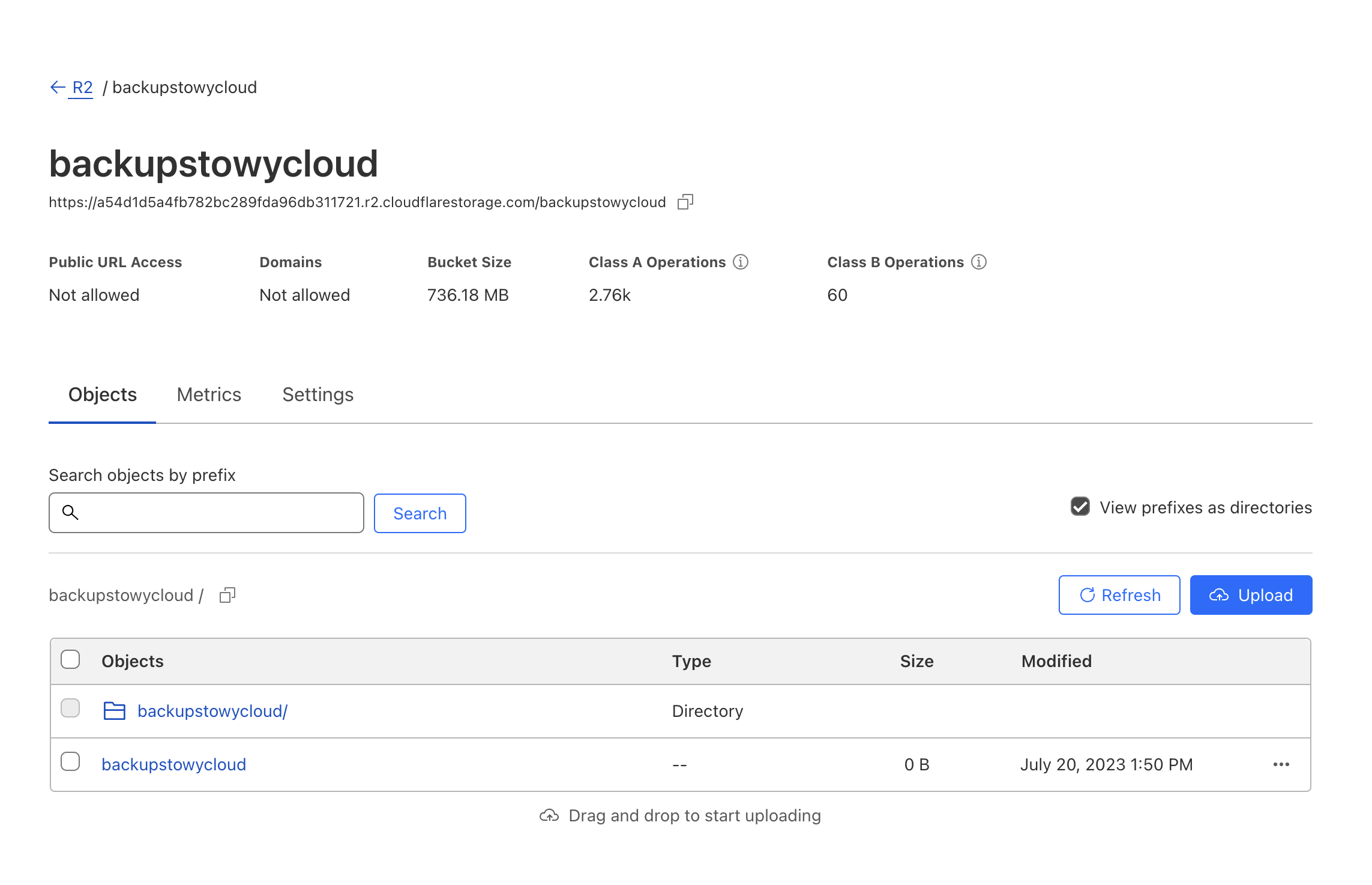

And when opening the bucket and no sub folders
If it is there is something wrong with you configuration but with system access It is hard for me to debug and guess.
For me root is like this
All the backups are in the directory, and it creates the file “backupstowycloud” by itself after deleting.
Then there must be something wrong with the configuration
