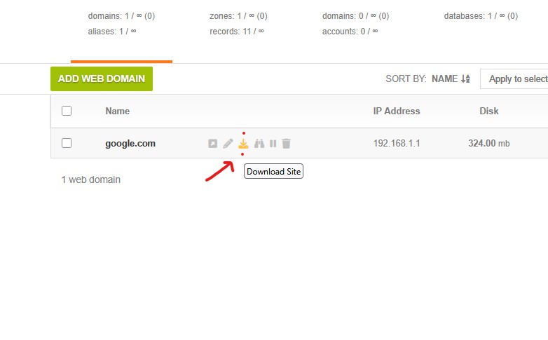

Im aware that there is an option to download site and download database in the web ui.
Is this download taken from an existing backup or does it download the latest state?
It downloads the latest state (current DB).
Thanks for clarifying, i assume it does the same for web files also?
No, it only dumps and downloads the DB, not the site files.
Sorry, I thought you said that downloading the DB would also download the site files.
Yes, downloading the site will include all your files inside the /home/USER/web/DOMAIN/ directory.
And it is also the latest state correct?
Yes, it zips the current files.
