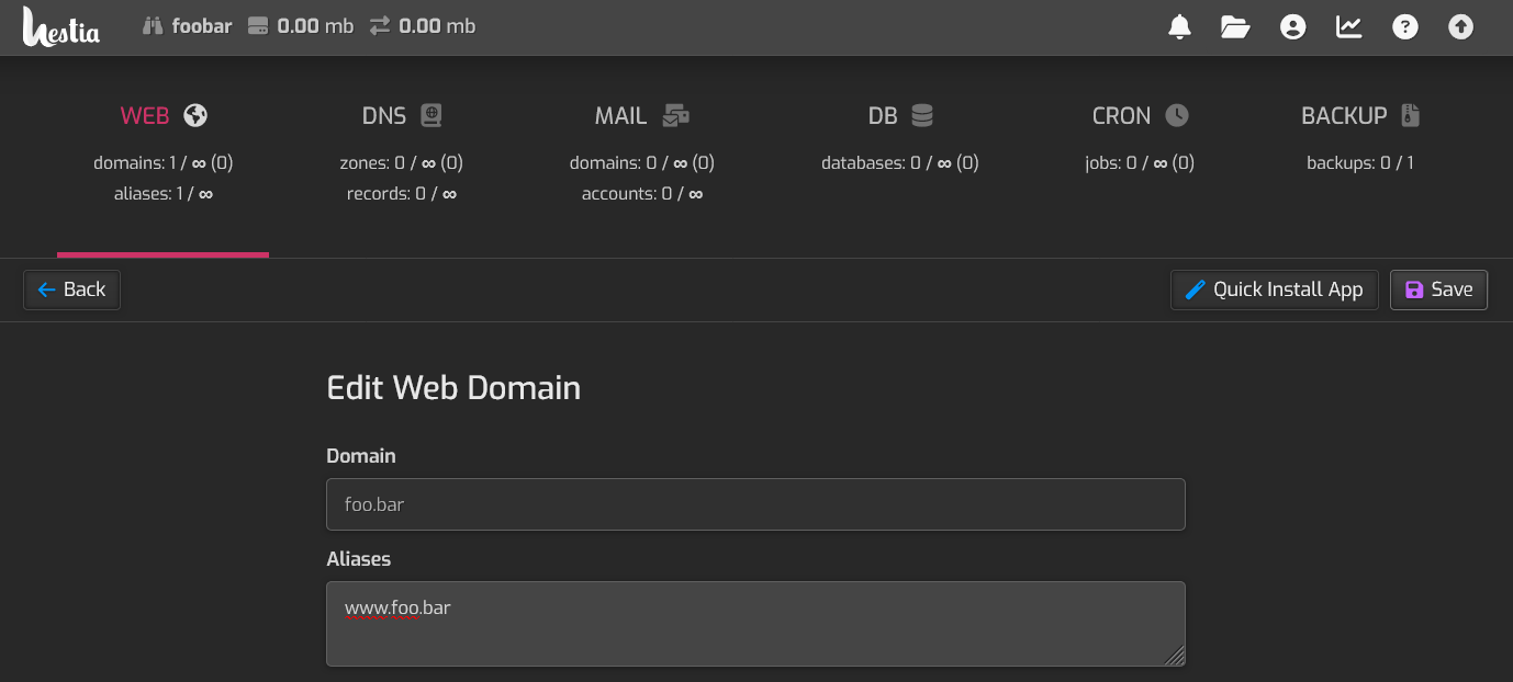

If you edit your web domain you should see the Quick Install App button:
Thanks, I couldn’t find it for some reason when I looked earlier.
Odd that most of them are grayed out
That’s because the required PHP version is not installed. Click on the Setup button of the application you want to install and it will show you which PHP version is needed (usually PHP 8.2 or 8.1).
