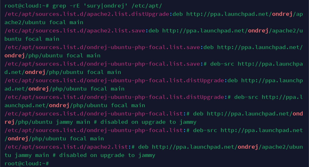

Are you using Debian or Ubuntu? What version?
grep -rE 'sury|ondrej' /etc/apt/
I am on Ubuntu 22.04
grep -rE ‘sury|ondrej’ /etc/apt/
That is the reason you can’t install php7.4-redis package, you are not using ondrej’s ppa, you have the lines commented in:
/etc/apt/sources.list.d/ondrej-ubuntu-php-focal.list
/etc/apt/sources.list.d/apache2.list
I don’t know why you have those lines commented but you should uncomment them and run sudo apt update and then you should be able to install the php7.4-redis package.
From which file i can uncomment this.
Whats the directory and file name.
From the files I wrote in my last post
thanks bro, issue resolved…
One more confusion, i am on ubuntu 22.04 mean jammy,
then i have to uncomment both lines or just first one.
If you sre not using source packages with the first one is enough.
If you are using apache, remember to uncomment the line in the other file.
