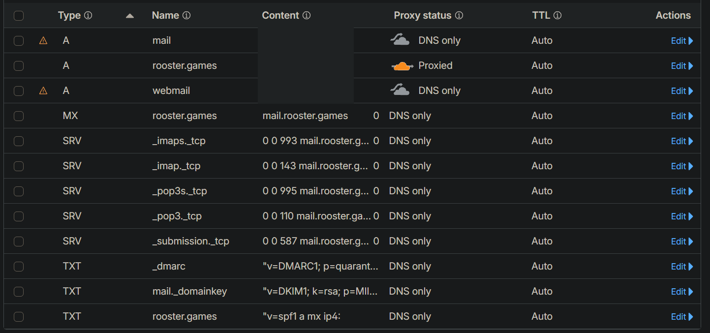

So after checking, turns out that now emails sent will save in the “Sent” folder but emails aren’t being received nor are they being sent. Another client’s email works fine so I’m not sure what’s wrong here. I just copied the MX and TXT records to Cloudflare since my client uses CF DNS.
Did you put a proxied hostname in the MX record? That’s the most common cause of what you describe.
The Cloudflare proxy only passes HTTP/HTTPS traffic. Hostnames that use other protocols need to be set as DNS Only.
Hey. I did make sure it was sent to DNS-only. Please see below.
Exim is rejecting all connections to your server because you are using a DNS resolver not authorized by Spamhaus.
