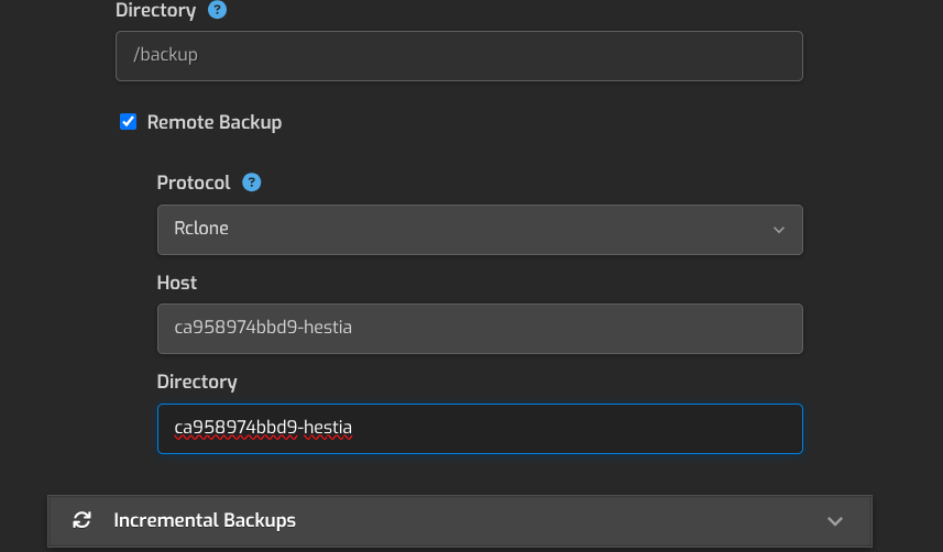

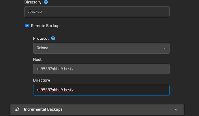

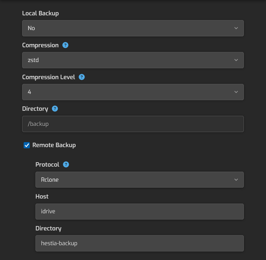

4. In the Hestia panel, I specify the rclone setting
Host
ca958974bbd9-hestia
Directory
ca958974bbd9-hestia
and also tried like this /ca958974bbd9-hestia
In the backapp folder, files just accumulate, but nothing goes anywhere

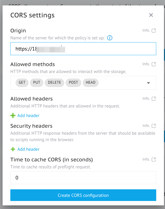

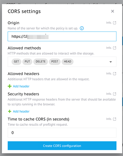

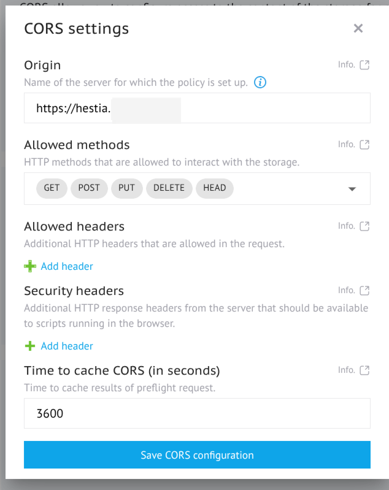

5. In the S3 settings, I registered CORS for the domain and for the IP, still errors.
Please, if anyone knows what else to do, tell me). Thanks

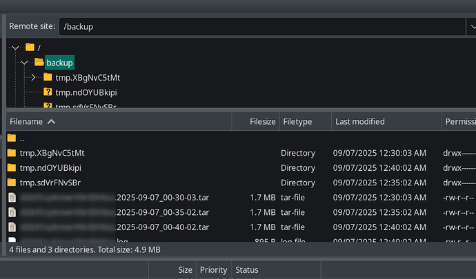

But the backup is still not sent to the panel, only tmp is spamming
what does sudo rclone listremotes give you ?
also what commands did you put in the fstab ??
i have the same setup
