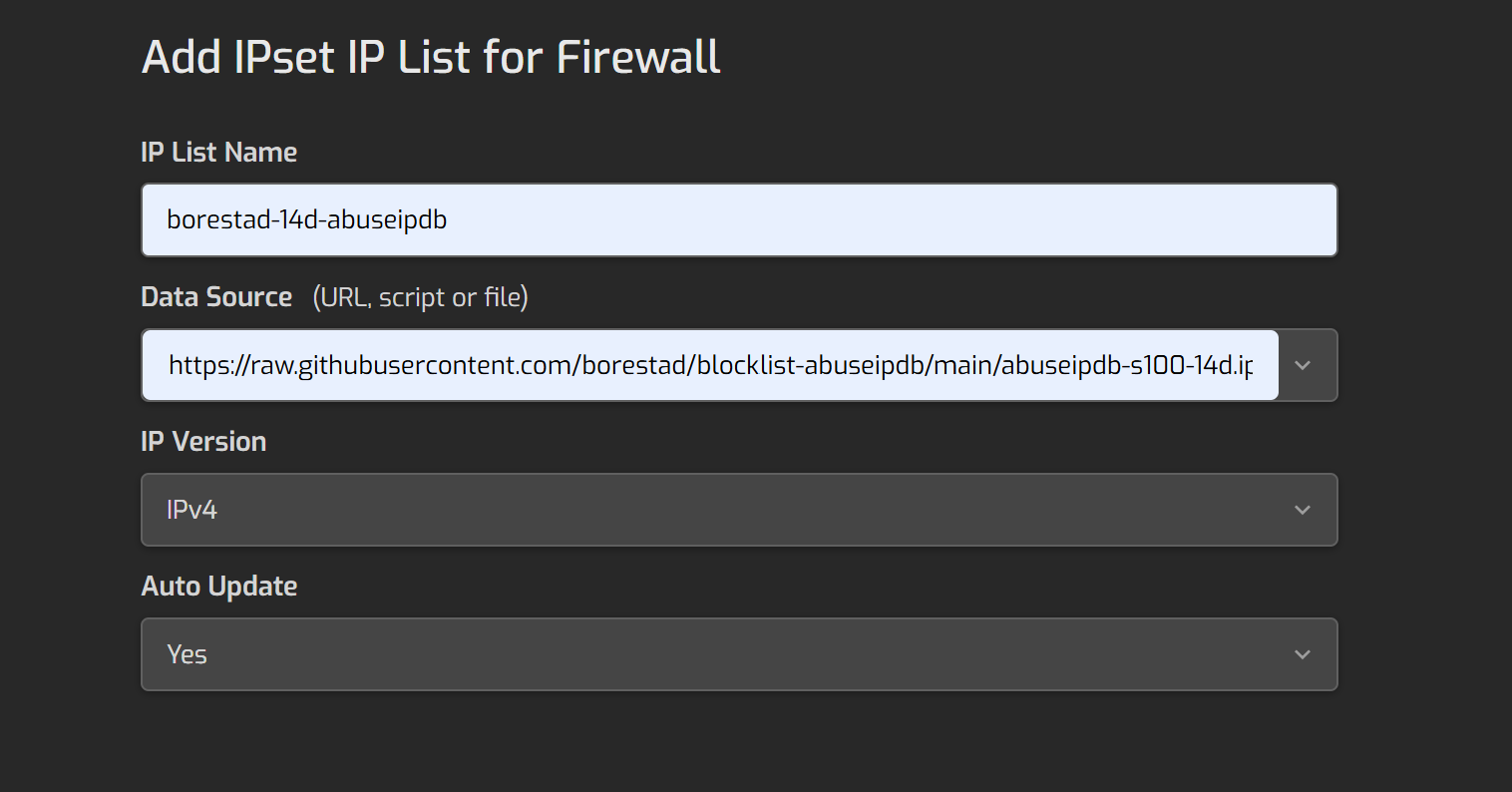

Finally, I decided to try with a direct approach to block IP list with AbuseIPDB (from this source → https://raw.githubusercontent.com/borestad/blocklist-abuseipdb/main/abuseipdb-s100-14d.ipv4)
Would like to seek for your comment on my implementation:
  1. Add the list to IPSet using GUI
  2. Add custom script as below (/usr/local/hestia/data/firewall/custom.sh)
#!/bin/bash
IPTABLES="$(command -v iptables)"
$IPTABLES -I INPUT -m set --match-set borestad-14d-abuseipdb src -j DROP
$IPTABLES -I INPUT -s {{XXXX.24(myipaddress)}} -j ACCEPT
  1. Run v-update-firewall
  2. Verify iptables -L INPUT
I can see the rules successfully added to the very top, below fail2ban rules and above original rules.
Just want to confirm if this is correctly implemented? especially that DROP policy “match-set”, is it the right policy?
Thanks so much

There is no need to add rules in custom.sh script, indeed you must add those ipsets in Hestia and create your own rules in Hestia to block incoming connections based on those ipsets.
