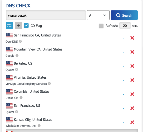

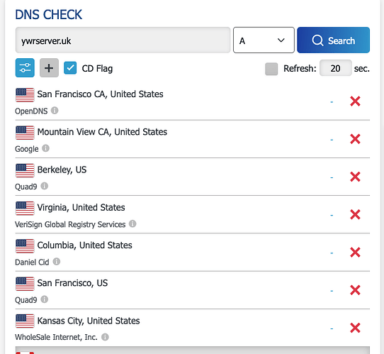

Because I see this, something is not right.
Screenshot 2024-09-25 at 23-05-51 DNS Checker - DNS Check Propagation Tool

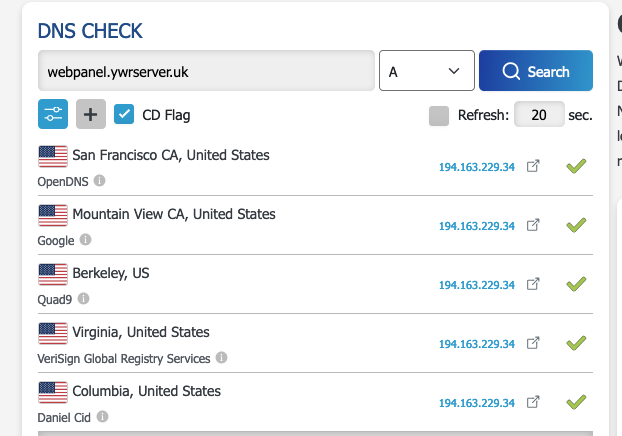

The only subdomain resolving is webpanel:
$ dig @194.163.229.34 webpanel.ywrserver.uk +noall +ans
webpanel.ywrserver.uk.  14400   IN      A       194.163.229.34
But you must configure the dns zone for your domain, so you must (at least) add both ns records ns1.ywrserver.uk and ns2.ywrserver.uk pointing to your public ip 194.163.229.34.
