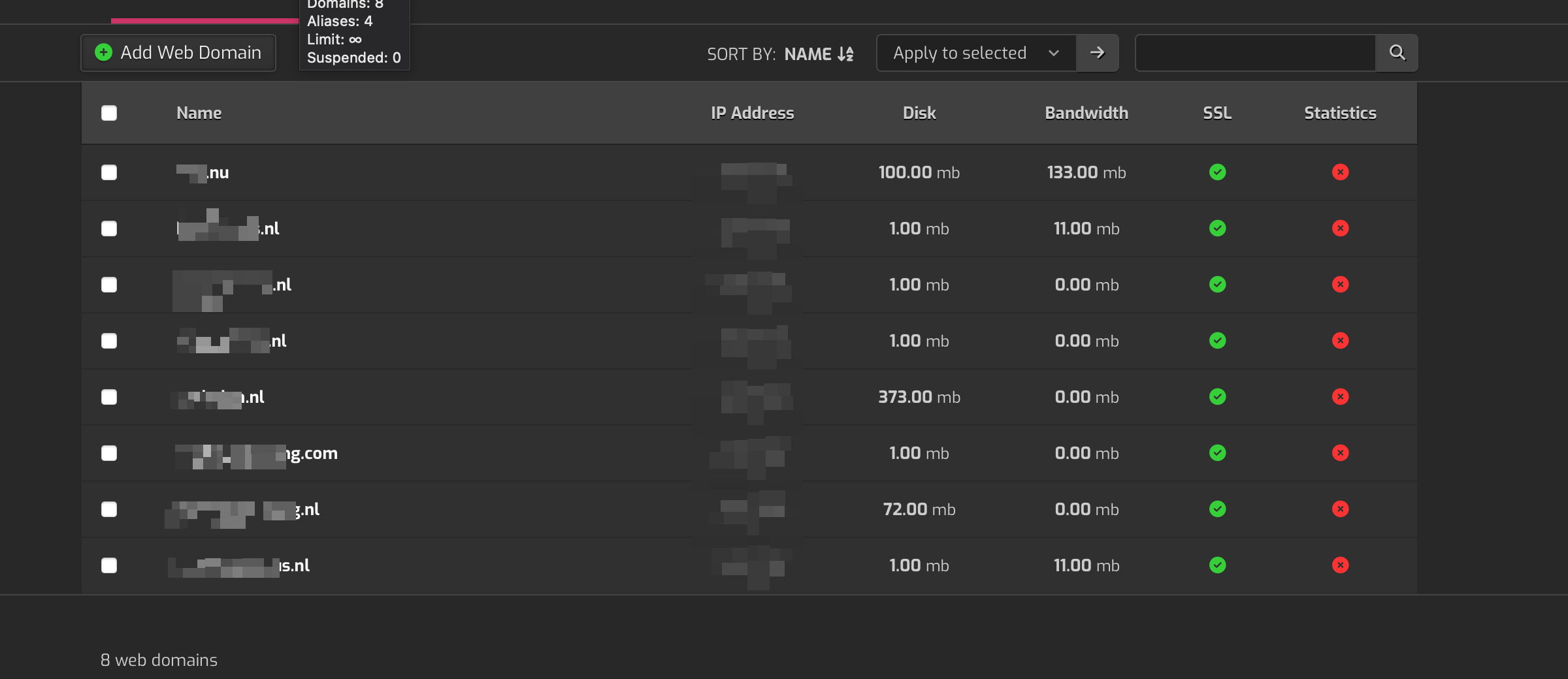

I have multiple domain running on it with out any problems …

Could you please explain in detail what are you doing? Because you only need to edit the web domain and select Enable SSL for this domain and Use Let's Encrypt to obtain SSL certificate (you can also add automatic redirection to HTTPS and HSTS) and once done Save
imagen
Do the same for all your domains.
